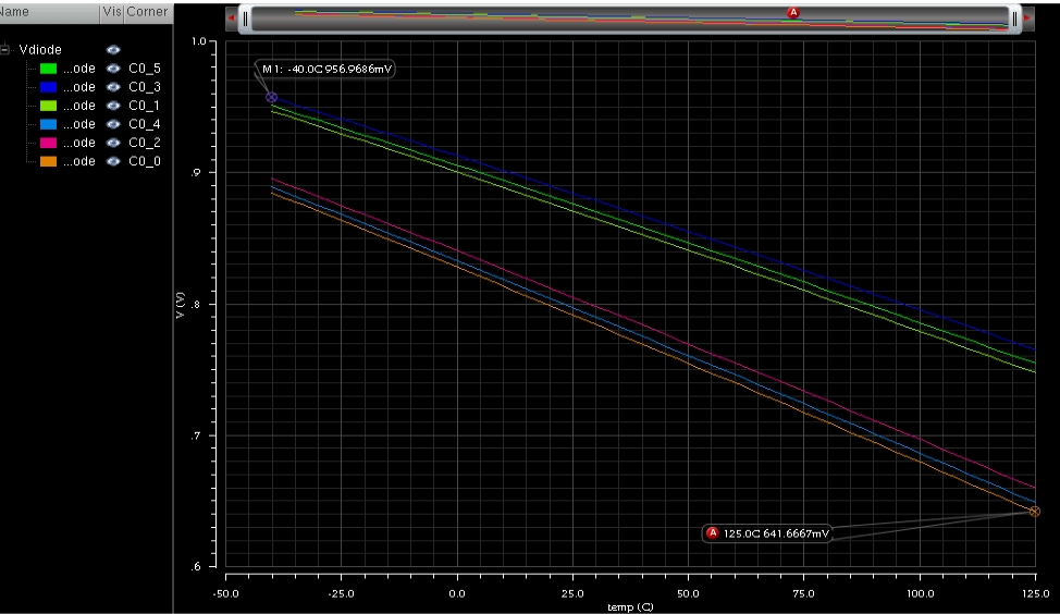

        thank your for your help,about the transistor: l tested our transistor voltage in different current ;it match the criteria 1 and 2;
    the plot is as follows:  the top is be voltage in 120ua ; the blow is be voltage in 7.5uA;
    about the criteria 4 how to verify it?
  • Hi again,
    Glad you were able to verify criteria 1 and 2 and actually provide us with a curve!
    Why are there three curves for each current level - what to they represent?
    For criteria number 4 - is this an integrated diode (in an ASIC, FPGA or other device)?
    If it is it's probably a vertical PNP transistor structure with is collector tied to the substrate of the IC. You can easily measure the beta of the transistor in question easily using a curve tracer. But - that will not give you the process spread, so I would recommend that ask the manufacturer of the device that includes the thermal diode to tell you. If that is you then you will need to actually measure enough devices to ensure you covered your process variation. Perhaps someone in your process/modeling team can help you.
    Can you describe to me your test setup that you use to measure the temperature of your MCU?
    How do you change the temperature from 115C to 125C?
    Can you send me your schematic?
