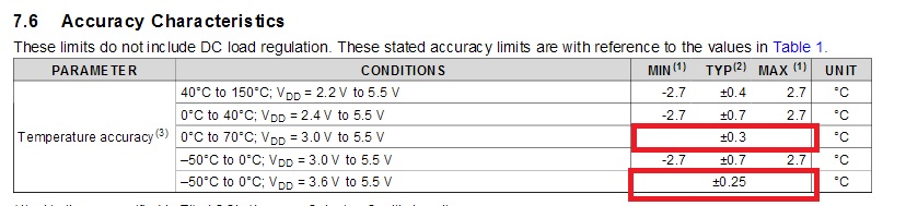

in lmt86 datasheet page 7 in accuracy characteristics table ( picture below ): why there is no any minimum and maximum value in specified rows ?
    Thank you for your inquiry. We do not have specific maximums for the rows you pointed out, thus it would be +/-2.7C. If you are looking for better accuracy please check out the LM94022. The LM94022 is a drop in replacement  for the LMT86.
