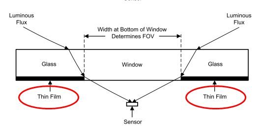

I checked app note for OPT3001 and find thin film solution. Can you tell me the example part number or material of this thin film?

    We do not make or sell thin-film. What the application is referring to is that end equipment manufacturers (like tablets or phone) will normally have glass and some kind of thin film that blocks out certain wavelength. What material they use for thin film is up to the vendor or glass manufacturer.
