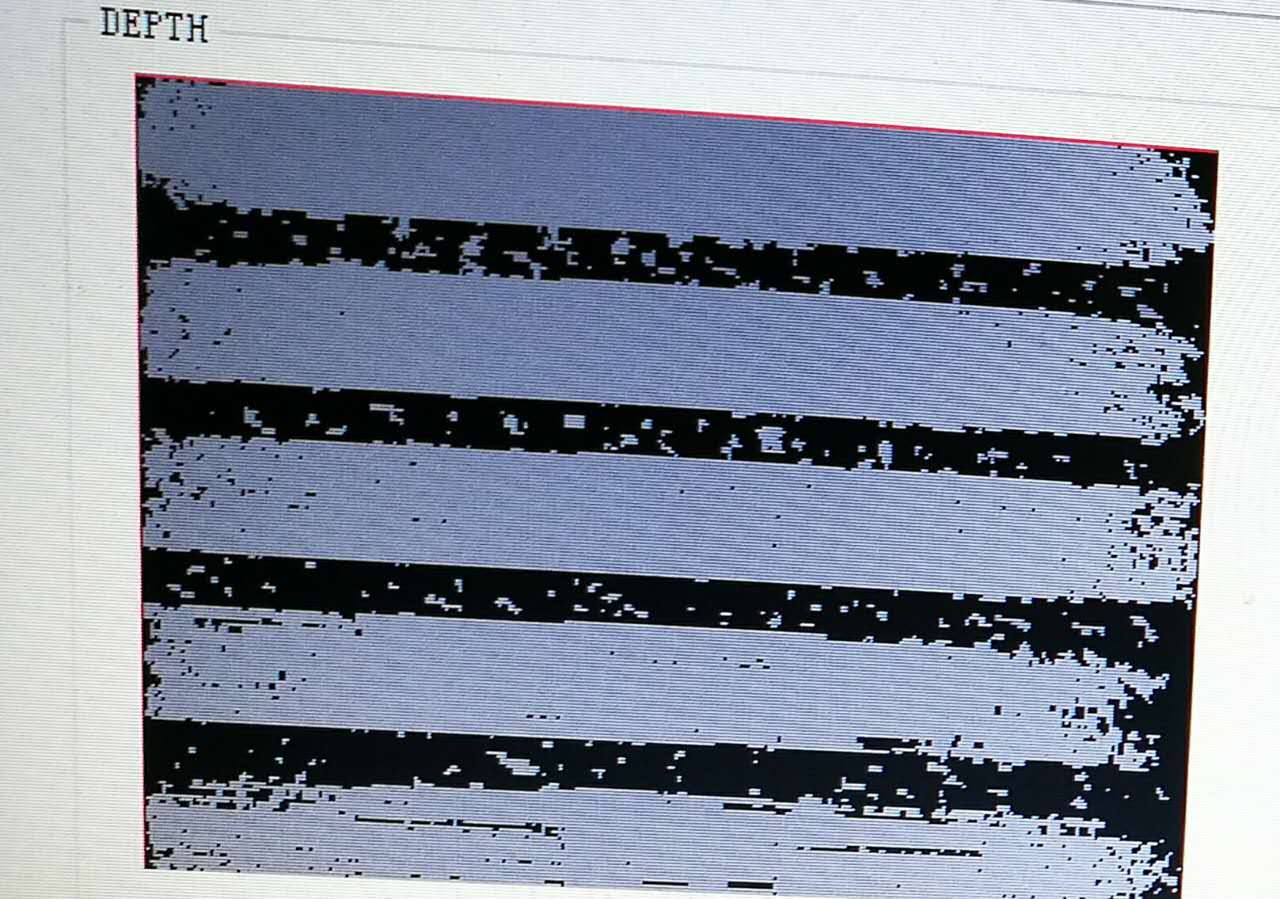

Hi team,
My customer has been evaluating our TOF EVM. In their evaluation, they see line noise as attached  below sometimes. and the noise affects bad for their analysis.
http://www.ti.com/tool/jp/opt8241-cdk-evm
Have you seen such the strange line noise on Depth data before?
If it's well known phenomenon for us, please let me know the cause of this issue.

  • Hi AnBer
         I am also appear this problem.
         I resatart the evm by software in 50 times,it appears one or two times,just like this.
         I want to this is why and how can i solve it? Thanks

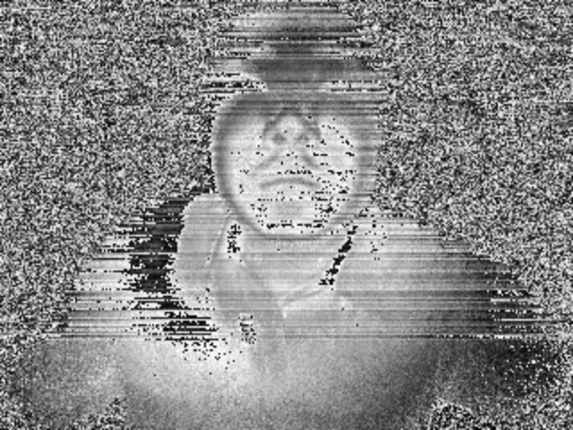

  • None:
    What does the image look like when turn on MAC_TEST_ENABLE? Now also try turn on PHY_TEST_ENABLE.
    -Larry
  • Dear Larry,
              thanks for you reply.
             when i set MAC_TEST_ENBALE=1,The image like this:
             when i set phy_test_enable=1,The image like this:
             I think my borad is ok. it only appear  one time in fifty times test. if i power on my borad again,it‘s ok.
             So Can you help me ?

  • Pattern looks fine. Given your situation is intermittent there could be many different possibilities. Next time you run into this issue, please take a note of what the Log window is showing, the status LEDs.

  • Hi Anber,
    Can you tell me more about information about this?
    thanks&regards.
    None
  • None and AnBer:
    Register 0x000000B1 is also changing for some reason. First, I saw some value of 0x00800000, which the bit 23 is read only and should read '0'. Other time I see the 0x000000B1 register reads 0x00285604.
    None: can you explain why 0x000000B1 register is fluctuating like that? Are you enabling delay_fb_corr_mode? I suspect this is causing the problem.
    -Larry
  • Hi larry,
    Thanks for you information.
    i I have no attention to delay_fb_corr_mode register in my config.
    should i disable delay_fb_corr_mode? i will just try it.
    thanks&regards.
    None
  • Try disable any FB correction, not only in your config file, but also read back to make sure it disabled.
    -Larry
  • Dear Larry,
    there is my config.
    [global]
    id = 130
    parent = 128
    name = Long Range
    [defining_params]
    unambiguous_range = 5
    mix_volt = 1500
    op_clk_freq = 0
    sub_frame_cnt_max = 2
    quad_cnt_max = 6
    frame_rate = 30.0
    mod_freq1 = 30.0
    mod_freq2 = 60.0
    pix_cnt_max = 133333
    ma = 1
    mb = 2
    ka = 3
    kb = 1
    freq_ratio = 2048
    dealiased_ph_mask = 0
    intg_duty_cycle = 20
    illum_power_percentage = 100
    delay_fb_corr_mode = 0
    delay_fb_dc_corr_mode = 0
    #delay_fb_coeff_1 =
    disable_temp_corr = 1
    [calib]
    freq_corr_at = 48.0
    freq_corr = 1.0
    actual_distance = 2.1
    tillum_calib = 43
    disable_temp_corr = False
    disable_offset_corr = False
    phase_corr_1 = 188
    phase_corr_2 = -385
    tsensor_calib = 51
    In order to disable FB correction. when i set delay_fb_corr_mode = 0 and delay_fb_dc_corr_mode = 0 in my config,this setup failed, i read back it again by voxviewer ,it still equal to 1.
    so What should I do, to ensure that it set a success,Only set success, I was able to confirm whether this problem will appear again.
    hope you can help me.
    thanks&regards.
    None
  • Create a new profile, say "Test123" by deriving from MetrilusLongRange (HW) as parent, but without doing any calibration. Do NOT save it to Hardware.
    On Windows, go to c:\users\<your username>\.Voxel.   On Linux go to "cd ~/.Voxel"
    In there you should find many *.conf file.  Look for "TintinCDKCameraTest123.conf".  Edit it and set delay_fb_corr_mode = 0
    delay_fb_dc_corr_mode = 0.  Save the file.
    Power cycle the CDK, and restart Voxel Viewer.  Select your new profile under "Camera Profile".  now use the parameter window to check delay_fb_dc_corr_mode = 0 and delay_fb_corr_mode = 0.
    Now, disabling these feedback will change your calibration, so you will need to recalibrate everything other than lens correction.  But disabling feedback will likely improve stability, so worth a try.
    -Larry
  • Dear Larry,
    In Tof sdk, there is code about delay_fb_dc_corr_mode & delay_fb_corr_mode,
    if ((int) _boardRevision[0] == 1) {
    _parameters.erase(DELAY_FB_CORR_MODE);
    _parameters.erase(DELAY_FB_DC_CORR_MODE);
    if (!_addParameters({ParameterPtr(new TintinCDKDummyDelayFBCorrModeParameter(*_programmer)),}))
    return false;
    if (!_addParameters({ParameterPtr(new TintinCDKDummyDelayFBDCCorrModeParameter(*_programmer)),}))
    return false;
    if (!set(DELAY_FB_COEFF1, 0U))
    return false;
    } else {
    if (
    !set(DELAY_FB_CORR_MODE, 1) ||
    !set(DELAY_FB_DC_CORR_MODE, 1))
    return false;
    so i have make
    !set(DELAY_FB_CORR_MODE, 0) ||
    !set(DELAY_FB_DC_CORR_MODE, 0))
    i will just test it ,Whether improve the data stability.
    thanks&regards.
    None
  • Dear Larry,
    I have changed the code,it make the delay_fb_corr_mode=0&delay_fb_dc_corr_mode=0.
    This phenomenos gets worse ,i have test 1000 times ,it appeared 55 times.
    Can you give me more information.
    Thanks&Regards
    None
  • None,
    If seems there is significant noise, which could come from many places. Also the bad I2C register values are still unexplained. If this is obsereved on our CDK, I suggest you get a different CDK and see if that help (return the old one as RMA). If the observation is on your own board, you will need to prove the voltage/signals and check on integrity of supply and signals.
    -Larry
  • Dear Larry,
    This is a probabilistic event,it also appear in OPT8241 CDK, As Takashi Onawa describes it at the first title it also have this issue.
    So It may be a problem with opt9221 firmware.
    if i want to return the old one as RMA, Can you give me the Communication window?
    Thanks&Regards.
    None
  • Please try this new OPT9221 firmware:https://e2e.ti.com/cfs-file/__key/communityserver-discussions-components-files/1023/OPT9221_5F00_FW_5F00_0v28.7z
  • Dear Larry,
    I will just try.
    I'm sure you should also have a probabilistic appearance about this question.
    Thanks&Regards.
    None
  • None,
    Could you please test with the official firmware 0.29 released here:
    www.ti.com/.../sbac142
    Anand
  • Dear Larry&Anand,
    In the beginning, the problem has been solved with the new firmware 0.29.
    I'll do a further test.
    thanks&regards
    None
