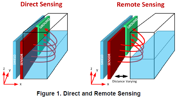

Hi Team,
My customer considers to design liquid level sensing application with FDC2212/4.
I found the following application note and there is "SHIELD" in Figure1.
http://www.tij.co.jp/jp/lit/an/snoa935a/snoa935a.pdf
Is the "SHIELD" assumed with FDC1004 because FDC2212/4 doesn't have shiled driver?
Is there any solution for the "SHIELD" with FDC2212/4 to prevent interference like human hand?
I believe I should select FDC1004 in this case but would like to confirm just in case.
