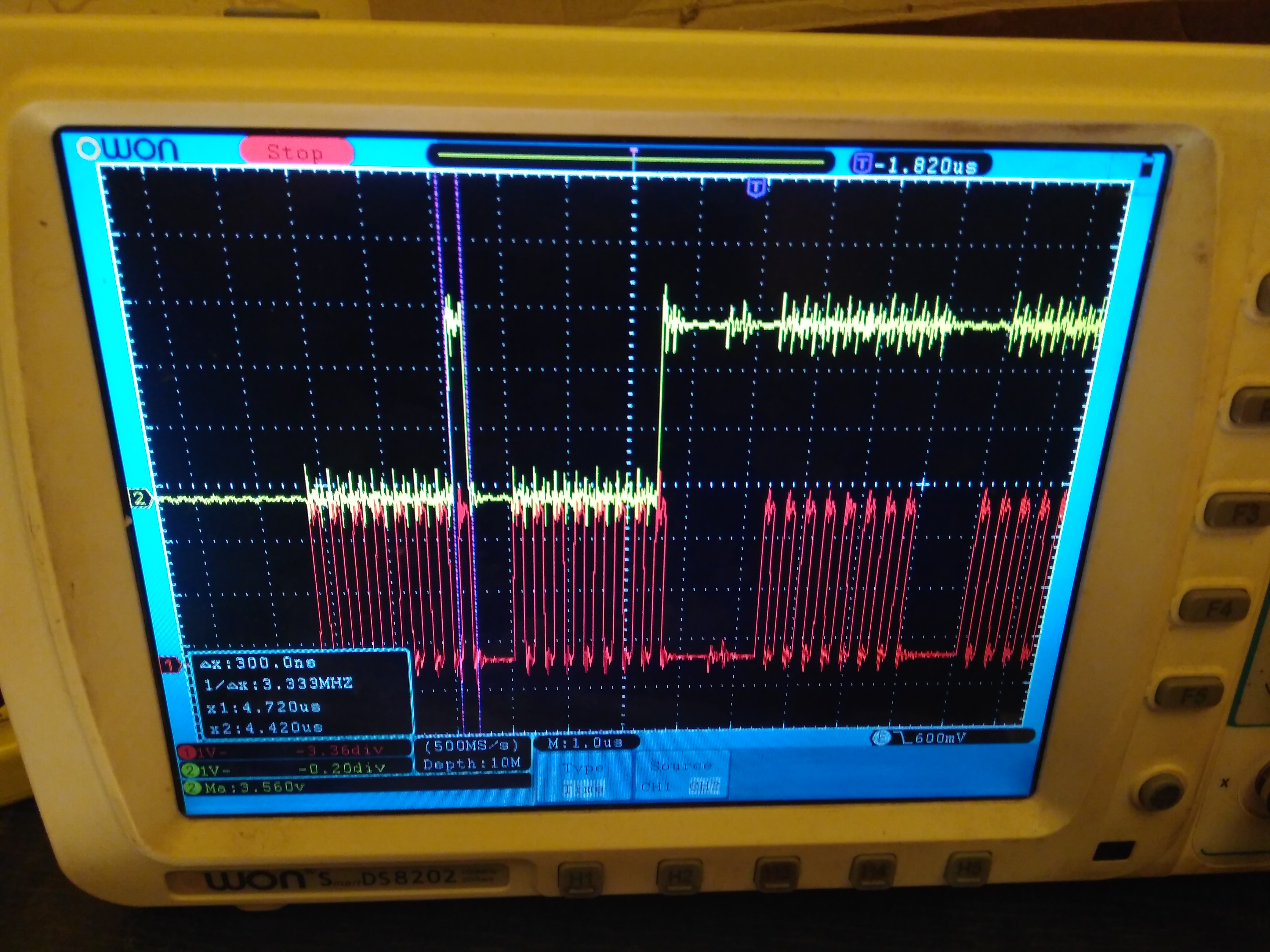

p.p.s. I have tried to turn on DRDY signal on INTB pin and found something strange.. you can see it here:
p.p.p.s. I made test pin to go high when error happened (status byte read as 0x30) and tried to catch this error. Experiments showed that it returns 0x70 instead of 0x30 when DRDY pin pulses high (conversion finished) at the end of first byte of read command (0x20, read from 0x20). I have attached a file when you can see that DRDY pin goes high at end of first command byte just before status byte will be returned. BTW, before this moment 5 DRDY pulses was already (without any read from device), so I caught 6th conversion end here.

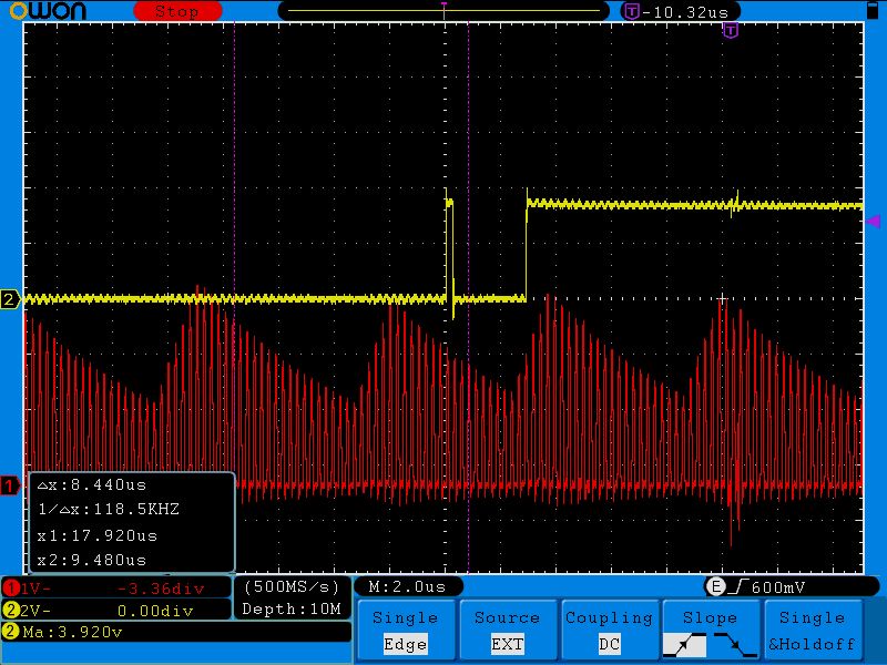

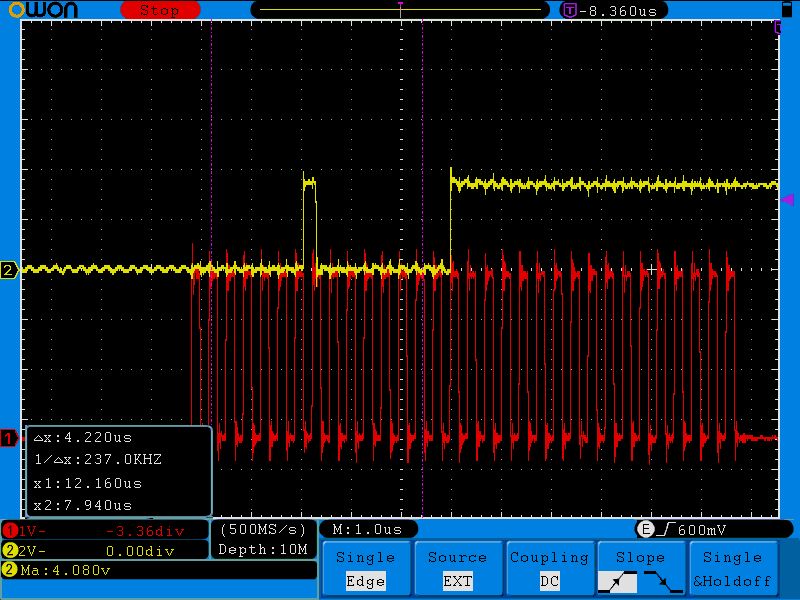

  • I have tried to get screenshots (I have two-rays oscilloscope only).
    Here you can see everything at all:
    A little bit closer:
    More closer:

    Each time I catch this situation, this happens when I'm trying to get data immediately before conversion was completed, so 8th clock of my read command fits with DRDY. I always getting 0x70 from status register in this case.
    p.s. Just tested LDC1101, it has no such errors, just reports data with status register 0x2C (no 'data not ready' cases was caught).
