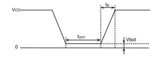

About power-up condition, Is there any minding point to operate power on reset normally?
For example, tOFF, tR, Vbot is as followings .
I'm recognizing that there is not description on the datasheet.
Kuramochi
Kuramochi
Yes, registers are reset by General Call Reset with Vcc between 2.7V-5.5V.
