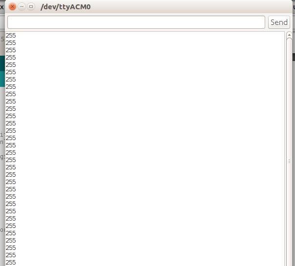

  • hello Akeem Whitehead. this what my algorithm and circuit is.
    tx of pga to 10 pin of arduino.
    rx of pga to 11 pin of arduino.
    Firstly am writing eeprom with bulk command
    And them am programming with unlock and programming command
    Finally am reading the eeprom values, but its only giving bunch of 255 values. I think bulk write and programming is not working properly in my algorithm.
    Can you please help me with this problem what am facing...

    And what am getting after reading from eeprom
  • Hi Pradeep,
    How are you powering the PGA460-Q1? The minimum supply voltage requirement is 6V. If you are using the Arudino's 5V rail to power the PGA460-Q1, our device will not function or work properly.
    Are you able to read any data successfully from the PGA460-Q1?
    Is the Arduino 3.3V or 5V logic level referenced? If the logic level is 3.3V, the PGA460-Q1's TXD and RXD pins are set to 3.3V by default, and should be working properly. If the logic level must be 5V, then:
    The digital voltage-level selection performed by the TEST pin is executed at device power up. On power-up, the
    device checks the level of the TEST pin. If the level is low, the digital output pins operate at 3.3 V. If the TEST
    pin is tied high (3.3 V or 5 V are both considered high state), the digital output pins operate at a 5 V. This
    condition is latched in the PGA460-Q1 device so that the test mux can further use the TEST pin as previously
    described. If the application requires that a 5-V digital output is used and a test mux output must be extracted
    from the PGA460-Q1 device, then a weak pullup resistor on the TEST pin can be connected as shown in
    Figure 40 (of the datasheet).
