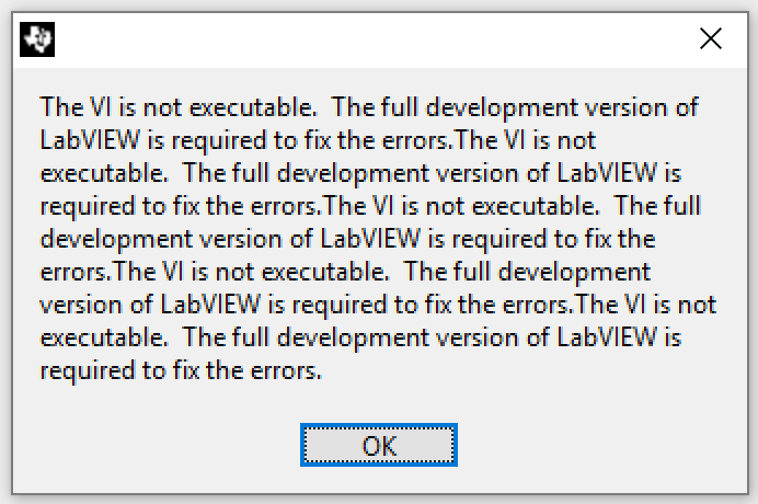

LDC1101EVM: The VI is not Executable - Full Development Version of Labview is required ?
Part Number: LDC1101EVM
Other Parts Discussed in Thread: LDC1101
Installed software from the version and I get the following error (see attached).
"The VI is not executable. The full development version of LabVIEW is required to fix the error".
Is there a way to evaluate without the full development version of LabVIEW?
  • Hello Luis,
    are you using windows 7 or 10? The installation on Windows 7 should take care of the Labview runtime engine automatically. If you are using windows 10, please try installing the labview runtime engine before installing the LDC1101 GUI.
