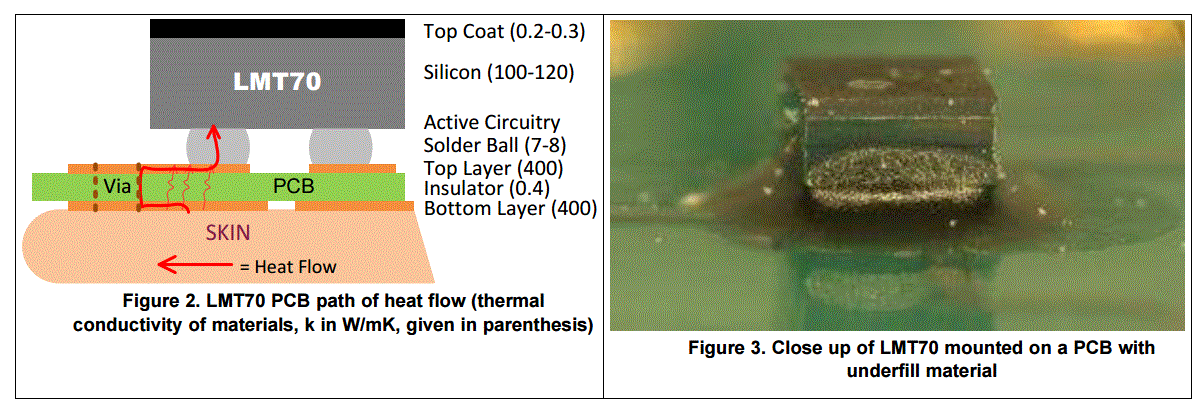

We noticed that the datasheet says that the thermal impedance through the top of the device is much better than through the connections on the bottom.  Do you recommend heat sinking to the top?
There is no data on heat transfer through the sides.  Is that an even better option?  Such as mounting the sensor in a copper block that contacts the sides and the top?

    Thermal conduction will be dominated by the metal leads or solder bumps (depending on package type). Using copper planes will help with the thermal response. The thermal conductivity of copper is ~300x higher than the package mold compound just to give you a sense. So you want to design the layout with that in mind.

  • The operating temperature range is very limited, certainly less than 0 to 50 C, maybe as small as 15 to 30 C. The present supply voltage seems to stay stable to a few microvolts, maybe better. This is a very specialized piece of test equipment we are building. We normally build computer controlled systems to calibrate such equipment and some of the more complicated calibration runs take 12 hours. So, process time is not really an issue. The entire system specs will be determined by how accurately we can resolve changes in temperature of the main pressure sensor. The time frame for stability is about 1 year. That is our normal recommended recalibration schedule. But what I really need to know is whether it is better to heat sink through the pcb or add another heatsink to the top or side of the device to better heat sink it to the pressure sensor we are calibrating. It appears from the data for this particular sensor, the LMT70, that there is a much lower thermal impedance path to the outside through either the top or the sides of the device. In fact, in one of the TI application notes it recommends adding "underfill material" that not only goes underneath, but partially up the sides of the device.

  • The most thermal conductive side of LMT70 is the bottom as indicated in the app note.  The underfill material improves the conductivity from the pcb to the die by removing the air gap.  I would recommend placing the heat sink at the bottom of the pcb and add copper planes with vias to optimize conduction to the die. Also use thermal grease.
