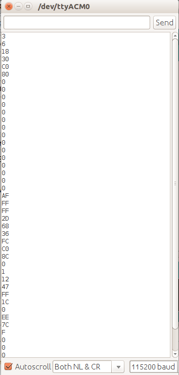

I had done pga460-Q1 with arduino. Now i am only able to read the reset values from pga460 using response commands but am not able to write eeprom and all threshold registers. I had triedto write using the appropriate commands but i can only read this below values what i attached to this post...
can anybody help me how to write..
Advance thanks
  • Hi Prapeep,
    What values are you transmitting for the EEPROM write? When you say "EEPROM write", are you trying to burn/program the EEPROM?
    If yes, to program the EEPROM, follow these steps (discussed in the PGA460 Software Development Guide):
    • Step 1. Send an EEPROM program command using UART or TCI with a unique unlock pattern of 4- bits. The program bit is set to 0 in the 0x40 register. The unlock passcode is 0xDh.
    • Step 2. Immediately send the same UART or TCI command with the program bit set to 1.
    If any other command is issued after the unlock code (Step 1), the EEPROM program sequence is aborted. If the unlock command in Step 1 is not correct, the EEPROM is not programmed. The EEPROM is locked again automatically after each program command. Example code of this is available in the PGA460 Software Development Guide on page 16 of 48.
    If no, and you are you trying to write to a single/bulk register(s), use the GUI's Interface Mode page to check your transmit values.
    For example, if you want to update the frequency value to 40kHz to a PGA460 with UART address 0, send: {0x55, 0x0A, 0x1C, 0x32, 0xA7}

  • thank you Akeem Whitehead..
    Now am ok with eeprom read and write.
    But the present problem is if i use bulk read command either EEPROM or Threshold. I will get first 5 bytes randomly. After 5 bytes am reading exactly what i had wrote.
    Suppose If  i read those equivalent registers one by one, then only i will get correct values.
    I don't know what is the problem. Even i changed the baud rates its not working properly.

  • Hi Pradeep,
    Is it possible that the first five random bytes you are reading are residual bytes from a previous command? You may need to flush or clear your serial buffer before reading data from the PGA460. After these five random bytes, does the for a EEPROM bulk read start at USER_DATA1 (addr 0x00) or USER_DATA6 (addr 0x05)?

  • Hello akeem whitehead
    1. Is it possible that the first five random bytes you are reading are residual bytes from a previous command?
    No those are not any residual bytes. Those are not related to any registers.
    2. You may need to flush or clear your serial buffer before reading data from the PGA460.
    yes of course am flushing the serial buffer before every read command. And also i tried flush after command. But its not working.
    3. After these five random bytes, does the for a EEPROM bulk read start at USER_DATA1 (addr 0x00) or USER_DATA6 (addr 0x05)?
    No its start from Data7(addr 0x06) to P2_gain_control.
