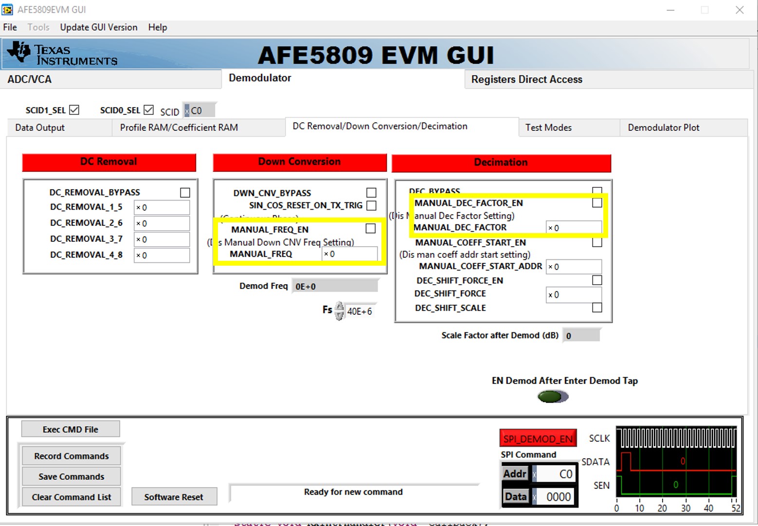

Hello TI people,
Our aim is to get 16 bit I and Q on LVDS output.
Here is the setup
We are using external signal off 500kHz sine wave at INP1 (Channel 1).
Onboard clock - 40 MHz
Power supply +/-5V
DC removal is bypassed.
Could you please answer these questions as the voltage levels previous applied hasn't given any results.
1. What should be the voltage level of the input signal? In this case, we are using sine wave. We are not using VCA or LNA.
2. How to setup down conversion frequency to 300 kHz using GUI?
3. How to setup decimation factor to 32 to get sampling of 1.25MHz?
Thanks!

  • Hi Raunaq,
    When you say that the previosuly applied voltage did not yield any results, what do you mean exactly? According to Page 32 of the datasheet, the linear range of the LNA is 1Vpk-pk. Anything exceeding that can lead to a distorted output signal.
    Furthermore, Page 65 of the datasheet shows how the register values affect the demod/down-conversion settings for the device.
    Sincerely,
    Olu
    We are using 300mV pk-pk for input signal amplitude. In the datasheet, 250mV is minimum for LNA input. We are not reconstruct the external signal applied. When internal test pattern is applied, for example RAMP, it is reconstructed clearly.
    Is there any particular setting we are missing for external signal?
    Thanks!
  • Hi Raunaq,
    Try out the different test modes and also verify that the DEMOD is setup for MSB first just like the ADC.
    Sincerely,
    Olu
