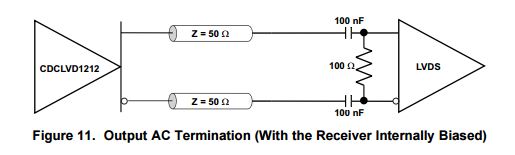

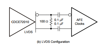

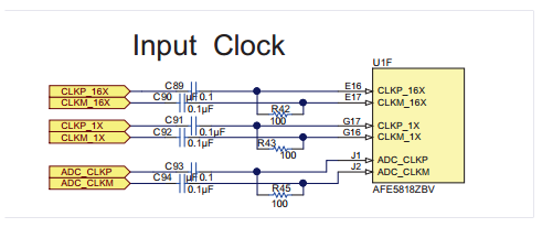

We use the AFE5818 and find different descriptions between the date sheet and EVM module for the input clocks as follow?
which is correct and why? Thank you.

Hi Olu,
Yes,we terminal as your suggestion.But we get atifact image, however, I get good image when remove the 100ohm teimination.I don't konw why. or need any check? Thank you.
