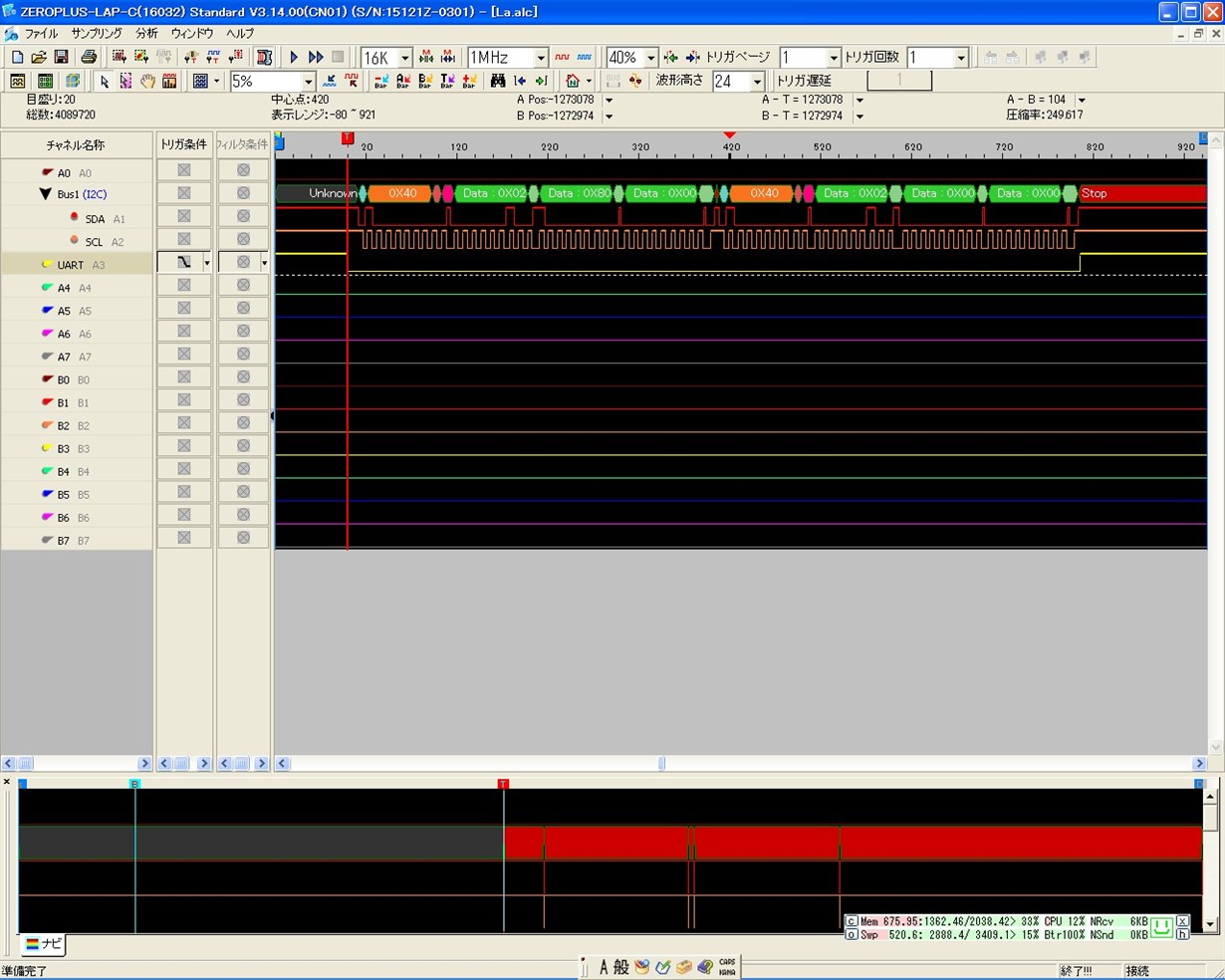

---question3
Could you please see attached image.
It is initial setting of I2C data.
It can be seen 2 times command writing and ACK response.
Is there any problem?

    3. It is ok to send a soft reset to the device, but your customer should wait about 10msec after the soft reset before to configure the device.
