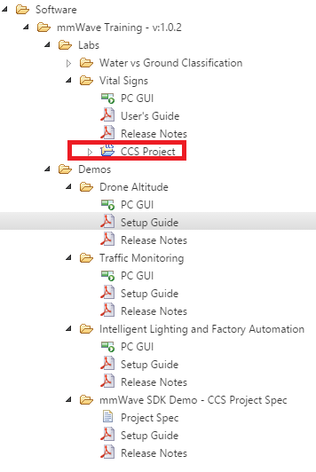

Can I get the source code of Demos (Drone Altitude, Traffic monitoring, and etc)?
The source codes are only available in Labs, but not Demo.

The xWR1443 mmw demo CCS project is available on TIREX at the same location under the Demos directory. Please refer to the provided Setup Guide which provides instructions for downloading, importing, building and running the project in CCS.
Only the CCS projectspec is provided as the project uses the source files from the mmw Demo directory in the SDK which is : <MMW_SDK_INSTALLL_DIR>\mmwave_sdk_01_00_00_05\packages\ti\demo\xwr14xx\mmw (typically C:\ti\mmwave_sdk_01_00_00_05\packages\ti\demo\xwr14xx\mmw)
