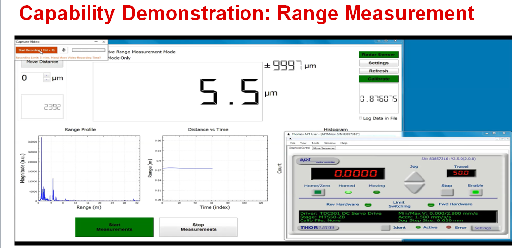

Our application requires computing range to a single object with high precision, similar to what is shown in the following demo.
We do not need micrometer precision as shown above, however 5mm would be desirable.  Can this be demonstrated with the current SDK?  If so, what parameters should be used?

    Our desired maximum range is 5m. Unfortunately 4cm is not sufficient. Our understanding was that the 1.0 SDK release would support higher precision measurements < 1 cm.
    What is the best way for us to proceed? Do you have source code available for the demo pictured above, perhaps? Can the 'mmw' demo be simply modified to add zero padding?

    To improve the accuracy to less than 4cm the best way forward is to modify the OOB demo's code to perform interpolation around the peak corresponding to the target, and thereby get a better accuracy in range estimation.
    For example, you could capture the range-bins at the range of interest, and then perform a quadratic interpolation on those samples to extract the true peak. This has to be done after the 2D FFT, during detection. Use the 2D FFT output for interpolation, not the 'detection matrix' output.
    The micro-meter demo requires that the target be perfectly stationary for a couple of seconds while the measurement is being taken. In case you need velocity information when using the radar, the micro-meter demo may not be suitable.
