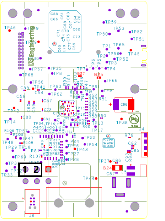

bonding pad got off, when we did some modification on the OPT8241 board, as is shown in the following figures, black line circled. I want to know if there is any chance to fix it and how to get this fixed.
Please check OPT8241 schematics for alternative location. Schematics files are located here:
http://www.ti.com/lit/zip/sbac138
Suitable spot might be a component junctions tied to power VCC_DC_JACK and GND.
