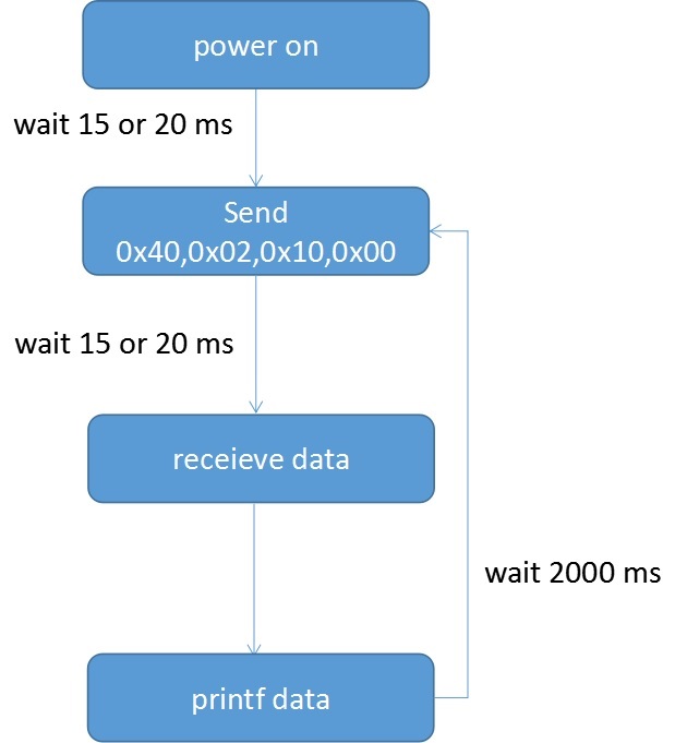

  • Hi Carmine,
    below is process flow chart, but what get data is 0x10,0x00,0xff,0xff. could you provide any advice?
    thanks~
    Driscoll
