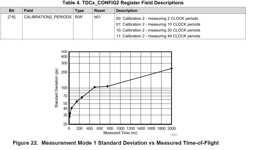

  2. How to set the calibration2_periods to make LSB smaller? From my understanding, the bigger the better, while from fig22,  when test higher then 200ns, the error will be bigger than 60ps,  is it result with calibrationed or not?  so it seems conflict.

    2. The LSB size does not depend on the number of calibration periods, only on the environmental conditions. The calibration only accounts for the error introduced by the environmental conditions, and increasing the number of calibration periods only increases the accuracy of the calibration. The chart that you show is the inherent error when using Mode 1, and can not be calibrated out. The reason the error increases so much above 500ns is because the internal ring oscillator is only useful for shorter time measurements. For measurements greater than 500ns, please use measurement mode 2.
