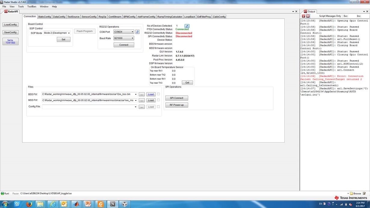

AWR1243: UART can not be connected in Radar stduio in customer's new AWR1243 board
Part Number: AWR1243
    I am debugging the new AWR1243 board in customer. We met a problem that UART can’t be connected on their board in Radar studio V1.7.4.0.  The snapshot is as below. We did below experiments:
  1. Use the same Radar studio and devpack to connect to their old AWR1243 board (with ES1.0), the connection works
  2. Use CCS to connect to AWR1243 via JTAG, it also works.
  3. Use FlashProgamer to erase and update the image in flash, it can work.
   Could you help to give some suggestion?
