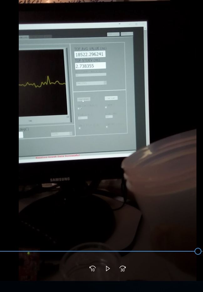

I would like to shere the results that I had today
With the TDC1000-TDC7200EVM
I made today experiment  of the  water level
My target today was to see changes of positives numbers  in the TOFAVG
While I am adding water to can
But instead of increasing  number of the TOF AVG
I I've got results of decreasing numbers
The  changes were very linear and stable
But in the opposite direction
then in  another experiment
As a continues with my experiments on the EVM
I managed to get the rising of the numbers while I add water
And it made by changing  in the
TIMEOUT(0X8) sector
FORCE_SHORT _TOF  TO ENABLE   in the TDC1000
But   I think that the level  of the water is not affect on the numbers
They increase in the start and then it stay there
No matter what is the water level

    Forcing short TOF with these settings allows you to measure up to about 10cm. If the level of your water is below this, then this should be fine. Otherwise you should disable short TOF mode and continue with the other timing settings you have.
    From your results it seems that you are not getting a proper return echo. Currently you have the gain set to 0, a single pulse, a mid-range echo quality threshold. You can increase the strength of your transmit signal by increasing the number of transmit pulses. In this case 2 should be fine (this is NUM_TX in  CONFIG0). Additionally, raising the PGA gain to 6dB or more will help you see a better return signal (PGA_GAIN in TOF-1). Finally, you can decrease the magnitude of the echo quality threshold to -125mV (ECHO_QUAL_THLD in TOF-1). For small ranges this should make sure the TDC1000 can actually see the return echo.

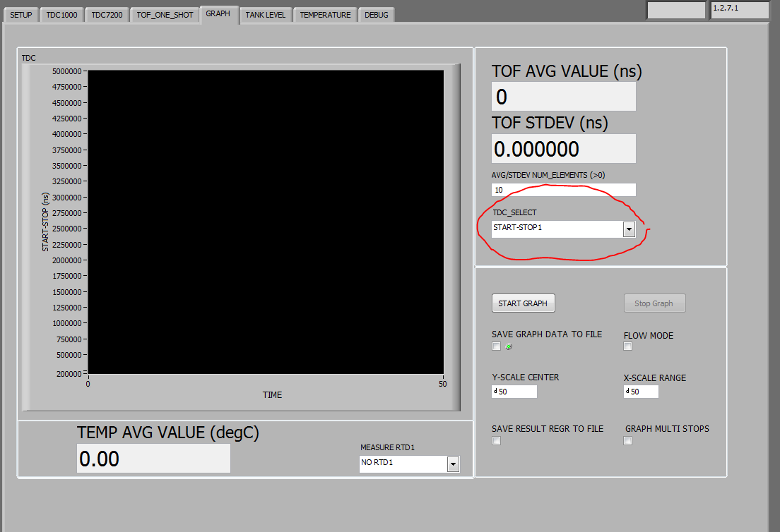

    Another possibility is that somehow an echo is returning from a surface early and at a fixed distance. You may be able to test this by increasing the number of stops the TDC1000 generates. Change the NUM_RX (CONFIG1) to 2 STOPS and the number of stops (TDC7200 tab, CONFIG2) to two.This will allow you to continue measuring past the first stop in case it is erroneous. You can view the TOF value for the different stops by changing the display in the graph tab:
    Finally, some of the trouble may come from the way the transducer is mounted to your container. Please review this app note on the proper mounting of a transducer for level measurement: www.ti.com/.../snaa266a.pdf
