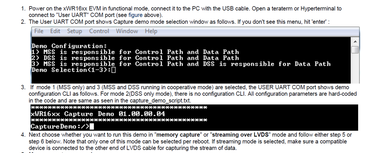

  • Hi Vivek,
    The information you provided was useful, but thing is, I imported the demo project into CCS and did all steps according to User's guide of mmWave SDK. But when I give give build to it, it shows nothing on the console window, and in debug mode I ran it according to steps, but I'm getting some files are missing, like e.g, boot.c etc.
    I can run it continuously, and I'm not getting any ADC data in memory location.

  • Hello Vinayak,
    If you want to debug Capture demo with CCS then here the steps you need to follow (mostly same as user guide)
    • Create CCXML file as given in section 4.3.3.1 (you may have done this already)
    • Launch and connect to both cores. section 4.3.3.2
    • Download 'xwr16xx_capture_demo_dss.xe674' to C674x and 'xwr16xx_capture_demo_mss.xer4f' to Cortex_R4. These debug images are built by the makefile given in mmWave-SDK Capture demo.
    • Resume execution of both cores.
    • Connect UART COM port as mentioned in section 3.4.3 and proceed with commands.
    Note-  Flash ccsDebug image to the device as given in section 3.3.2 before starting with above-said steps.
    mmWave-SDK has the makefile framework to build the demo applications. Even though you can create CCS project for demo at your end.  Follow this e2e post to create CCS project for mmWave device.

  •  Hello Jitendra,
    Thanks for the information.
    I have done all the steps you mentioned, except UART COM port commands, I'm not getting how to open CLI window to connect UART COM .
    Please give inputs to it.
