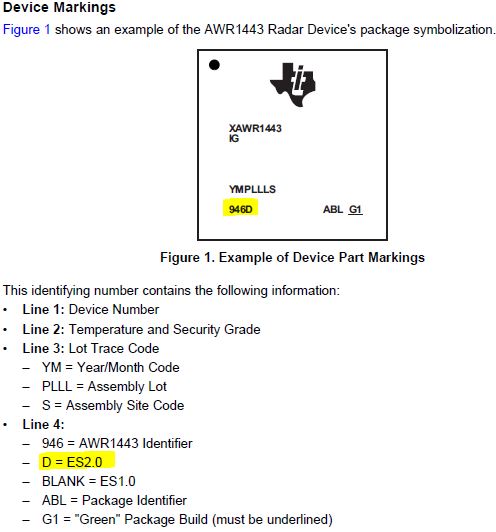

Since mmWave SDK 1.0 does not support AWR1443 ES1.0 (AR1443EVM-010) how can I find out if my EVM is affected?
