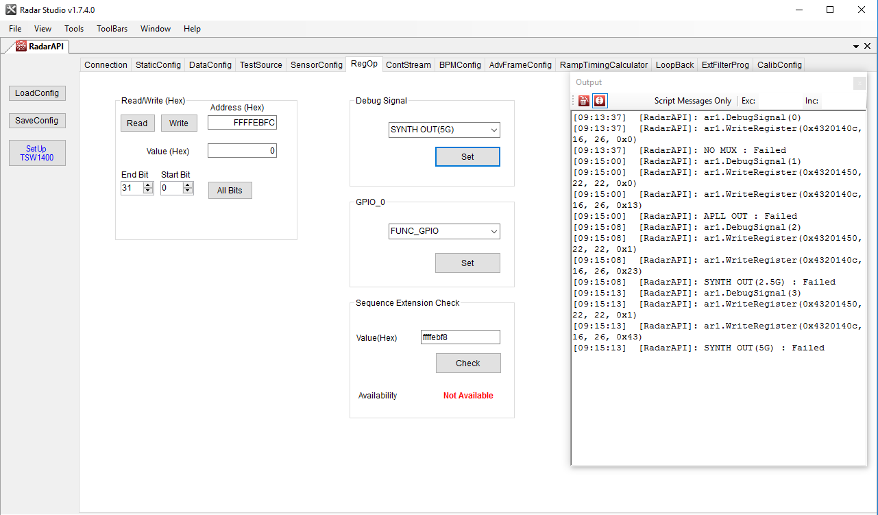

    1. According to the AWR1243 datasheet, OSC_CLKOUT is a cleaned up version of the 40MHz crystal oscillator. And I could not get OSC_CLKOUT on the "Debug Signal" output. Rather, none of the selections of the "Debug Signal" worked, as you can see from the script message screen capture. Can you please let me know where I did wrong?

    1) Regarding the failure you are seeing in the radar studio , can you let me know the DFP version you are using? Also can you make sure you are trying to get the debug signal out after you have configured the sensor (ie done the static config, data config and sensor config)?

    Thank you for following up. We no longer get the errors after reloading the FW.
