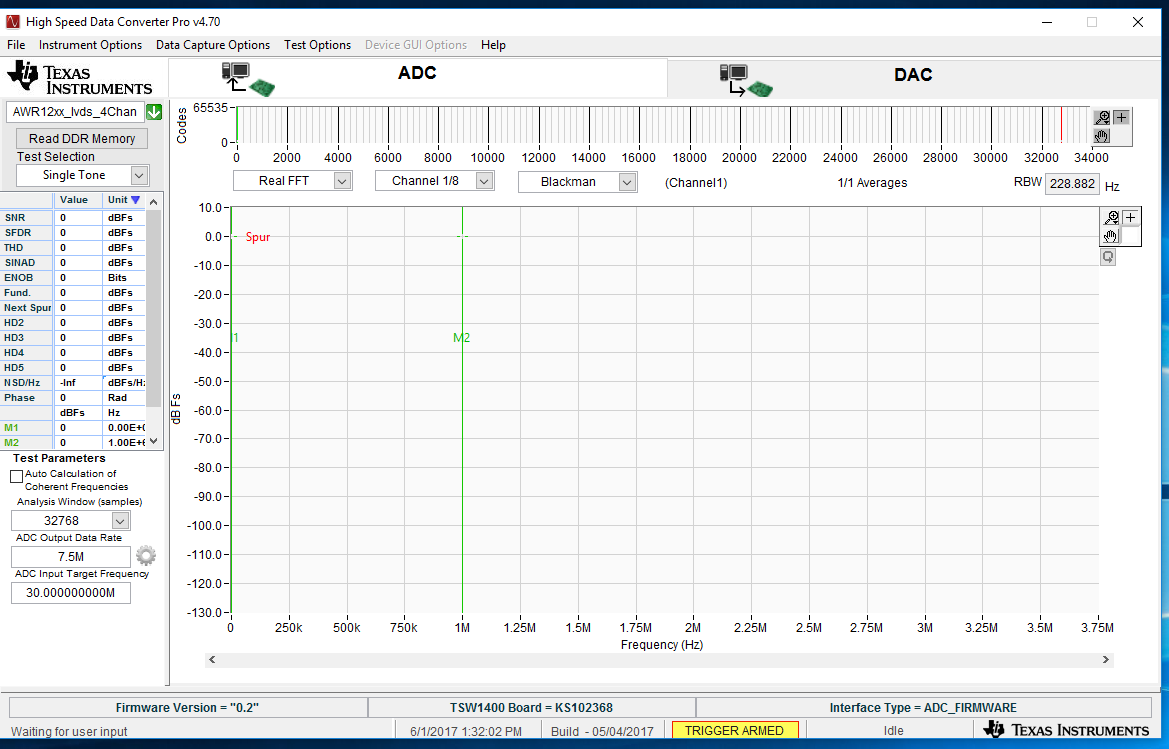

We have the 3 board (AWR1243BOOST + MMWAVEDEPACK + TSW1400) combo all connected together, and goal is to collect adc data with the hsdc pro tool and also try out post-processing in radar studio.
The AWR1243BOOST + MMDEVPACK was configured with Radar Studio. The TSW1400 was connected and the firmware loaded with HSDC Pro. All the software has been downloaded from the mmwave-dfp.
All the firmware and ADC files were also copied as outlined in the Radar Studio User Guide.
The AWR1243BOOST+DEVPACK was configured and everything connects without any errors including dataconfig and laneconfig.
The default chirp configuration is used. 128 chirps in loop + 40 ms periodicity + 256 samples per chirp + 10 frames. Sampling frequency is default 10 MHz.
First profile is set, then Chirp and then Frame.
Then I click SetUp TSW1400, and then click on TSW1400ARM. then I trigger the frame (I can observe the current increase during the duration of frames to indicate that the set up is chirping).
After Trigger Frame is done, I get the message in output shell that No data was collected.
Meanwhile, the HSDC Pro still shows that the Trigger is armed. Seems like it did not get the trigger (please refer to second below).
The adc_data.bin file is created but it is 0 KB in size. All the LEDs on TSW1400 are ON except USER_LED4, which is expected.
I tried different variation of periodicity and number of frames, but have not been able to collect any data.
The same issue also persists in CW or ContStream mode.

  • RJ,
    Did you wait for 1 second after you click TSW1400 ARM button, then click Trigger Frame? Below info can be found in radar studio user guide.
    6. ARM TSW1400. Wait one second.
    Or after you click the TSW1400 ARM button, pls check the status of HSDC Pro (at left bottom ) and see the status changes to "Check D3 bit", then click Trigger Frame.

  • Hello RJ,
    Can you try pressing 'Trigger Frame' immediately after pressing 'TSW1400 ARM'? Do not wait between these two. I know the guide says to wait but we have found that it works best when you press one immediately after the other.
  • Hi Aozer/Chris,
    Thank you for your suggestion. I have found a sequence which works under the chirp mode at least. The steps are as follows:
    1. Set up the TSW1400 before configuring the AWR1243BOOST + DEVPACK. This includes loading TSW1400 firmware.
    2. Once the TSW1400 is set up, then go through the AWR1243 set up in radar studio the way it has been prescribed.
    3. I have been able to log data using this sequence.
    4. If any settings change in Chirp, Profile and/or Frame Config, the AWR1243BOOST needs to be reset again for the new changes to take
    place. Then I have been able to collect data. If I change params, and then go do a TSW1400 setup, TSW1400 ARM and Trigger Frame, the set up does not work and no ADC data gets collected.
    I am not sure if this is how things are supposed to work. If this is how the set up is then it would nice to update the manual.
    I still have issues getting data in ContStream mode.
    RJ
