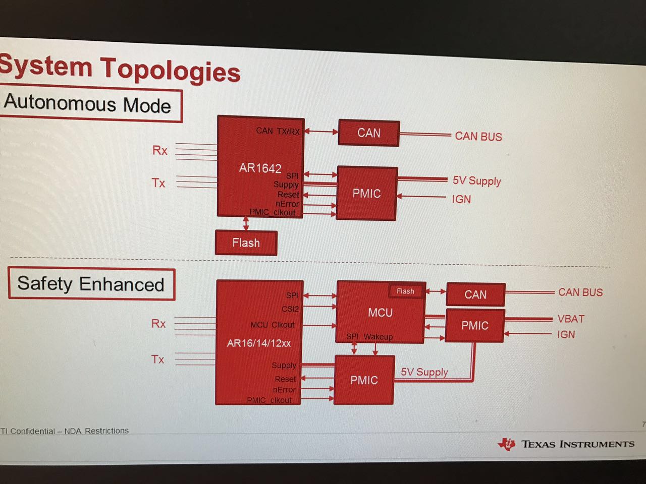

AWR1642: How to use LP8752 control the reset of AWR1642
Part Number: AWR1642
   In TI's Autonomous Mode radar system topology, we can see the NErrorOut and NREST of AWR1642 are connected to LP8752 (see below figure). Does it mean AWR1642 can send error signal to LP8752 when exception happens and then use LP8752 to fully reset itself? If yes, which pins in LP8752 can serve this application?
