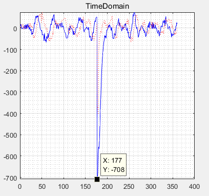

We used AWR1443 only. And load image of CaptureDemo project. Use CCS to export one frame of one rx raw data. The sensor setting as:
# adc 16bit 5MSPS complex 360points
# fmcw 77g 360m/72us
flushCfg
dfeDataOutputMode 1
channelCfg 2 1 0
lowPower 0 0
adcCfg 2 1
adcbufCfg 0 0 0 1
profileCfg 0 77 2 4 78 0 0 5 1 360 5000 0 0 30
chirpCfg 0 0 0 0 0 0 0 1
frameCfg 0 0 128 1 20 1 0
sensorStart
But there is a strange spur per chirp. Is any setting wrong?

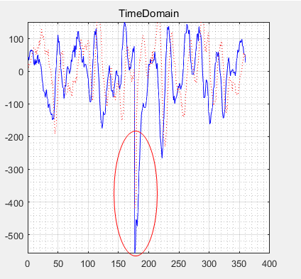

  • Hello Yang Shen,
    In the capture demo the radar data memory allocated is 128KB. From the configuration you have sent looks like radar data memory required is more than 128KB: 360 samples per chirp * 4 bytes per sample (16 bit complex) * 128 chirps.
    Can you reduce the number of chirps per frame so that the memory requirement is <128KB and try again?
    Vivek
  • Hi Vivek,
    Thanks for your reply.
    I reduce the chirp number to 64. But the glitch still here.

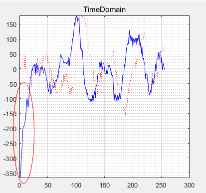

    Then I test the default setting .
    flushCfg
    dfeDataOutputMode 1
    channelCfg 2 1 0
    adcCfg 2 1
    adcbufCfg 0 0 1 1
    profileCfg 0 77 20 5 80 0 0 40 1 256 8000 0 0 30
    lowPower 0 0
    sensorStart
    If set frequency slop as 4MHz/us
    profileCfg 0 77 20 5 80 0 0 4 1 256 8000 0 0 30
    The glitch appeared at first several bins.
    Frequency slop can't be too small?
    Yang Shen

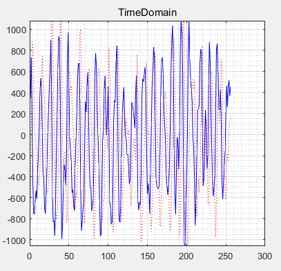

    But if I modify ADC sampling rate, sampling points, frequency slop, etc, some glitches still exist.

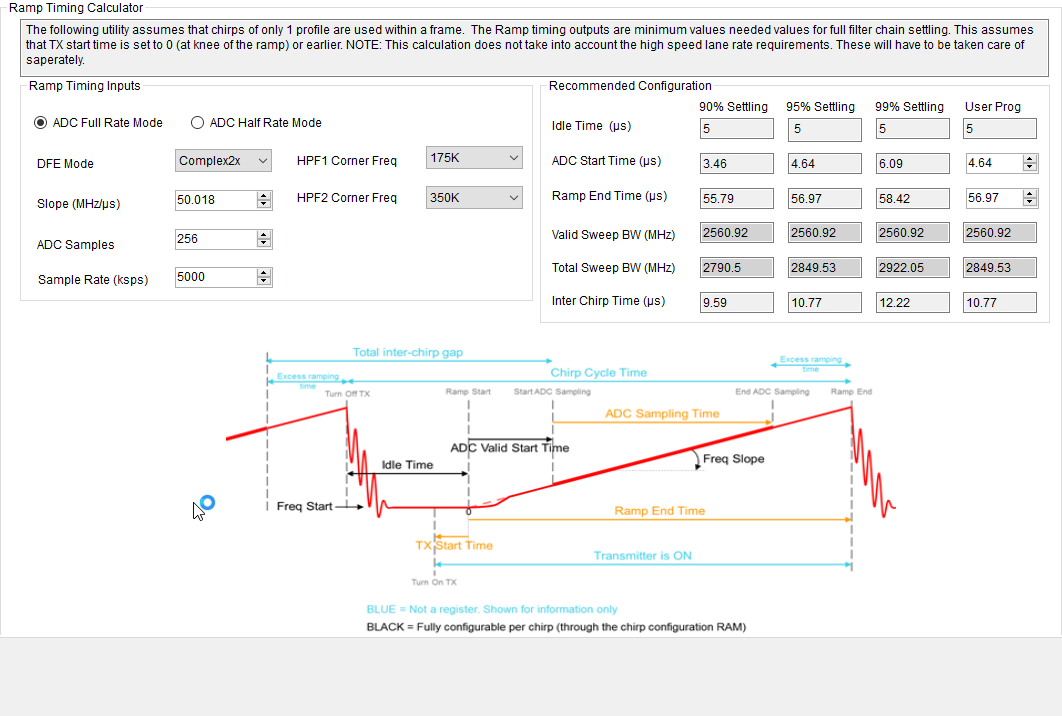

    Where or what tools for customs can I use to check my configuration?  I use Radar Studio now.
    Yang Shen

  • Hello Yang,
    Just to confirm I understood it right , by reducing the TX start time to 0 the initial "settling" like behavior is gone?
    To help select the right configuration you can use the sensing estimator tool (dev.ti.com/.../). You need to make sure the radar data cube used is within the allocated memory size. For example in the AWR1443 capture demo this memory is set to 128Kb. So when you change the configuration just make sure its still within this size.
