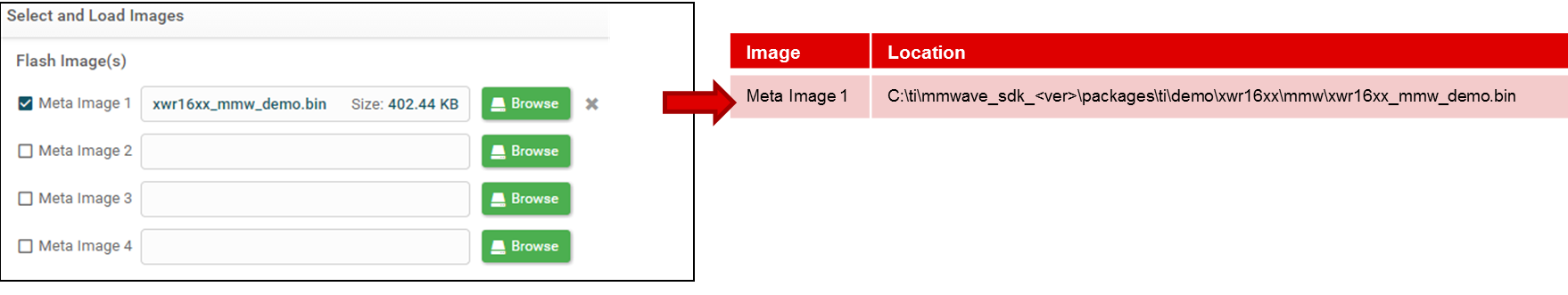

I am new to CCS and AWR1642. Bear with me for the basic doubt. I want to load the mmw demo program into flash to work with the mmWave Demo Visualizer. These are the things I have done.
Process1: I used Uniflash as given by the demo videos/PDFs. In the Meta image 1 and meta image 2, I chose the 16xx version (C:\ti\mmwave_sdk_01_00_00_05\firmware\radarss\ xwr16xx_radarss_rprc.bin). The step by step guide asked to load the "C:\ti\mmwave_sdk_<ver>\firmware\radarss\xwr12xx_xwr14xx_radarss.bin".
Error seen was  Header of C:/ti/mmwave_sdk_01_00_00_05/firmware/radarss/xwr16xx_radarss_rprc.bin file indicates it is not a valid file to flash to AWR1642: 0x43525052
[ERROR] CortexR4_0: !!! Aborting flashing of specified files!!!

  • Hello Santhana,
    You will only need to select the xwr16xx_mmw_demo.bin file from the C:\ti\mmwave_sdk_01_00_00_05\packages\ti\demo\xwr16xx\mmw folder. You do not need to use the radarSS .bin file.
    Please try flashing this image and let me know if it works.
    Adrian
  • Santhana,
     the xwr16xx_mmw_demo.bin already includes the radarss. Try Uniflash one more time and only select xwr16xx_mmw_demo.bin.

  • Hello Santhana,
    For the AWR1642 you will always just use one image. This is because the radarSS and masterSS are contained in the single image for the AWR16xx. Two images will always be required for the AWR1443.
    To load your code in CSS you will only need to use the ccsdebug binary, just as you did with the demo. The radar_rprc binary is not needed. To be honest, I am not entirely sure when the radar_rprc is used. I will have to get back to you on that.
