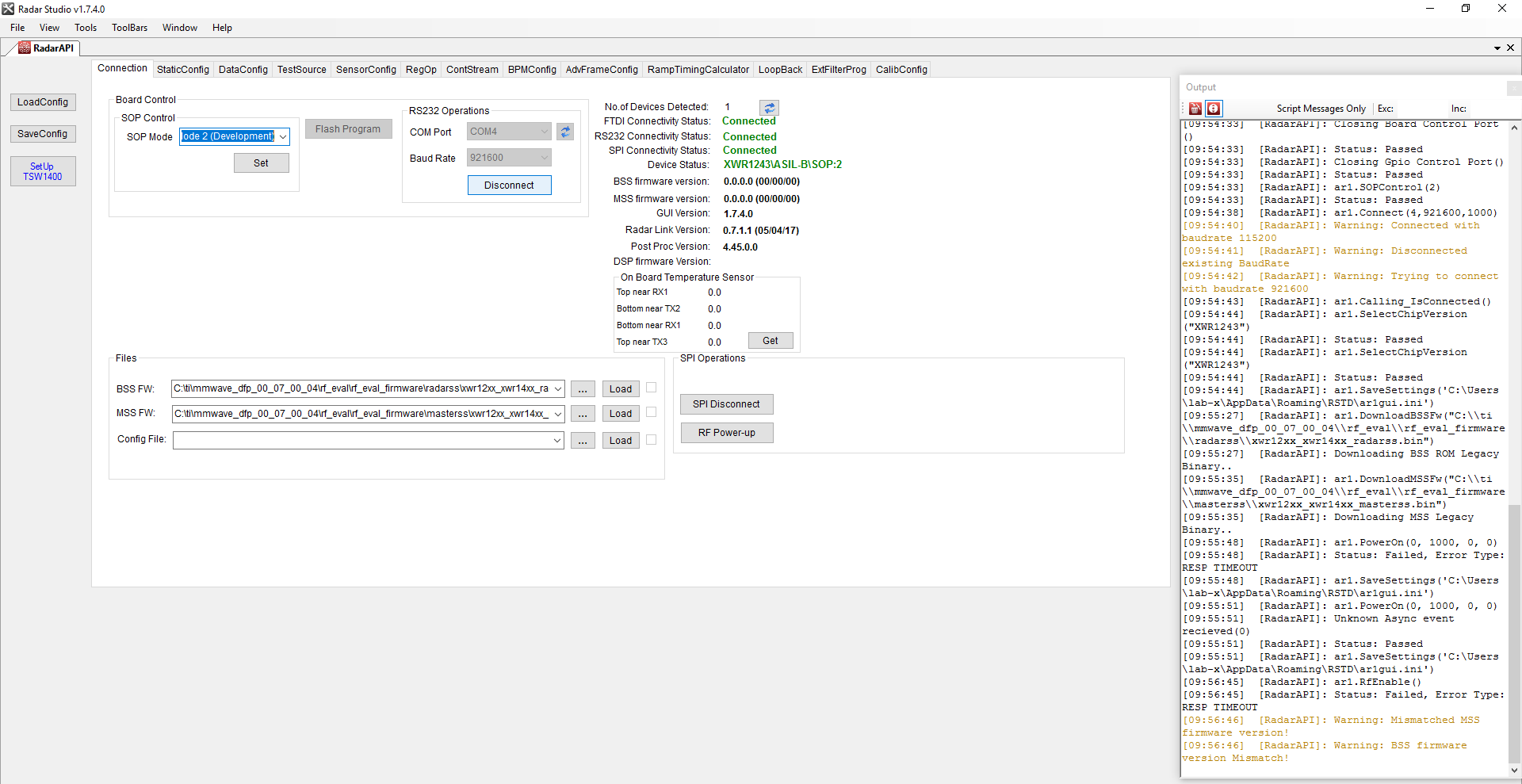

  • Hi Vivek: Thank you for your reply. The output window of radar studio showing the error is attached below. There are two issues I have currently:
    1. OSC_CLK_OUT
    When I try to go to RegOp and configure the debug signal to be either 2.5G or 5G output, I get the Failed message which i believe is attached to ar1.WriteRegister function call.
    2. GPIO_O
    When I configure this as ADC_VALID, I do not get any errors from the radar studio side which is great. However, I probed GPIO_0 on the mmwavedevpack and I am not able to see any activity on this pin. I am
    expecting a pulse at the beginning of adc data collection for every chirp.
    I probed some other pins like the 3.3V and some other pins just to make sure that my set up is not an issue.
    Thank you,
    RJ
  • Hello RJ,
    In the snapshot you have sent I see that there is a warning of firmware mismatch. Have you downloaded the right BSS and MSS firmware that is available in the "\mmwave_dfp_00_07_00_04\rf_eval\rf_eval_firmware\radarss" and "\mmwave_dfp_00_07_00_04\rf_eval\rf_eval_firmware\masterss" paths of the DFP installation?
    Also you need to make sure that you pick the "xwr12xx_xwr14xx" one since you are using a AWR1243 EVM.
    Vivek
  • Hi Vivek,
    Thank you for your reply. I have downloaded the firmware BSS and MSS firmware from the file folder locations that you have mentioned in the post.
    Figure 1 below shows the radar studio window after SPI Connect but before RF Power Up. This shows the BSS and MSS firmware version.
    Then when I click RF Power Up, the firmware versions are set to all zeros and the output window shows firmware version mismatch warning. Please see figure below. The current consumption goes up to 270 mA, and I have been able to get the AWR1243 to chirp and also be in CW mode. Of course the original problem mentioned in my previous post still stays.
    Thank you for your help, Vivek !
    RJ
  • Additionally in the RegOp tab, any attempts to read the registers also results in an error.
  • Hello RJ,
    Looks like the SPI connect is not succeeding. Can you erase the onboard serial flash before you connect the radar studio? You can do that from Radar studio also by setting SOP mode 5 and clicking on "Flash program" without checking any of the check boxes beside the FW files locations. That should bring up a command prompt where it would try to connect to the COM port and erasing the flash.
    Alternatively you could also use the uniflash utility (www.ti.com/.../uniflash) based on the instructions in the SDK user guide (software-dl.ti.com/.../mmwave_sdk_user_guide.pdf).
    While using the Uniflash utility make sure you remove the radar EVM from the devpack board.
    Vivek
  • Thank you Vivek ! That was a good catch. After flashing the serial flash, I got rid of the firmware mismatch warnings.
