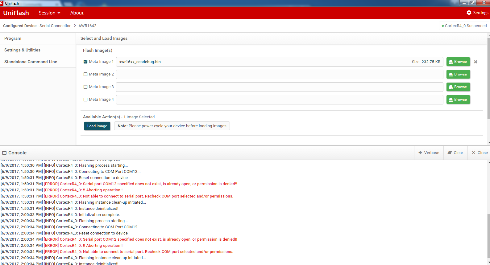

I'm trying to flash the demo image to my AWR1642BOOST EVM usin Uniflash , but its not flashing the image. I followed steps as per the user guide , but still its showing error as in screenshot attached to it. Please help.
  • Hi Vinayak,
    Based on the snapshot the errors seems to be regarding the COM port not being available.
    Can you please check that:
    - the port selected in uniflash tool matches the one shown in device manager
    - AWR1642BOOST is in Flash mode based on SOP pin setting.
    Thank you,
    Vaibhav

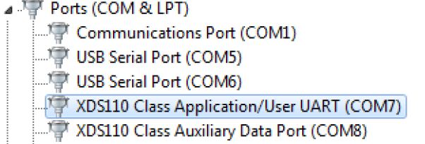

  • Hello Vinayak,
    When you power up the EVM and connect the USB cable do you see the  COM ports in the device manager as shown in the image below? If yes have you selected the correct COM port number (under the settings&utilities  tab) which is listed as "application/user UART"?
    Vivek
