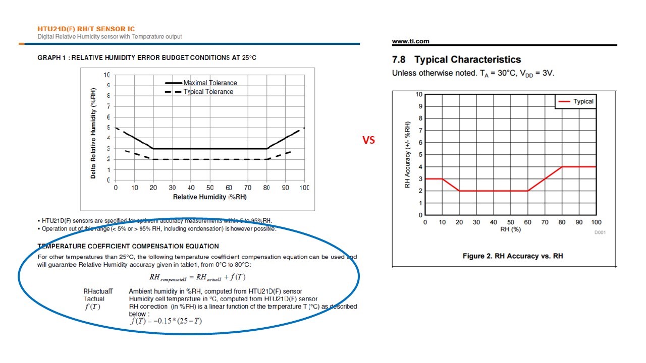

We are using HDC1080 which datasheet mention that humidity accuracy is +2%.  But we found that Humidity Accuracy we got from testing is higher than + 2% when temperature changing (ie 40C - 60C degree).
Does it have any equation to do compensation the Humidity accuracy to be  + 2%  ?
    The HDC1080 is already compensated in temperature.

    Is it sure that HDC1080 no need compensation ?  Is it guarantee humidity accuracy is +2% from 0-80C degree without temperature compensation ?
    Could you please double confirm again ?
    We used one from competitor brand TE p/n HTU21D. In the datasheet also said accuracy is +2%.  But it also need temperature compensation equation to guarantee the humidity accuracy is +2% from 0-80C degree.
