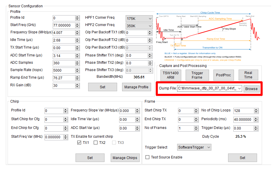

Our hardware setup:  AWR1642BOOST + AR1xxxEVM + TSW1400.
We use TSW1400 to capture adc data. I want to know what format of dump file. How rx/chirp/frame array?
Is there any script like mmwave_sdk_01_00_00_05\packages\ti\demo\xwr16xx\capture\gui\capture_demo.m to process adc raw data?
  • Hello Yang Shen,
    If you are using the Radar studio tool there is an inbuild post processing application in the tool. Once you collect the data you can click on "post proc" which would process the captured data and provide multiple plots and analyses of the captured data.
