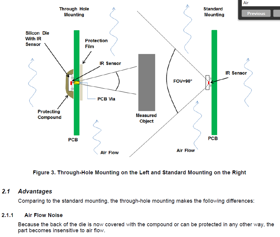

The documetation associated with the TMP007 shows a "protecting compound" covering the TMP007 when using through-hole mounting as shown below.
What is the make/model of this compound? Can you please suggest a supplier?
