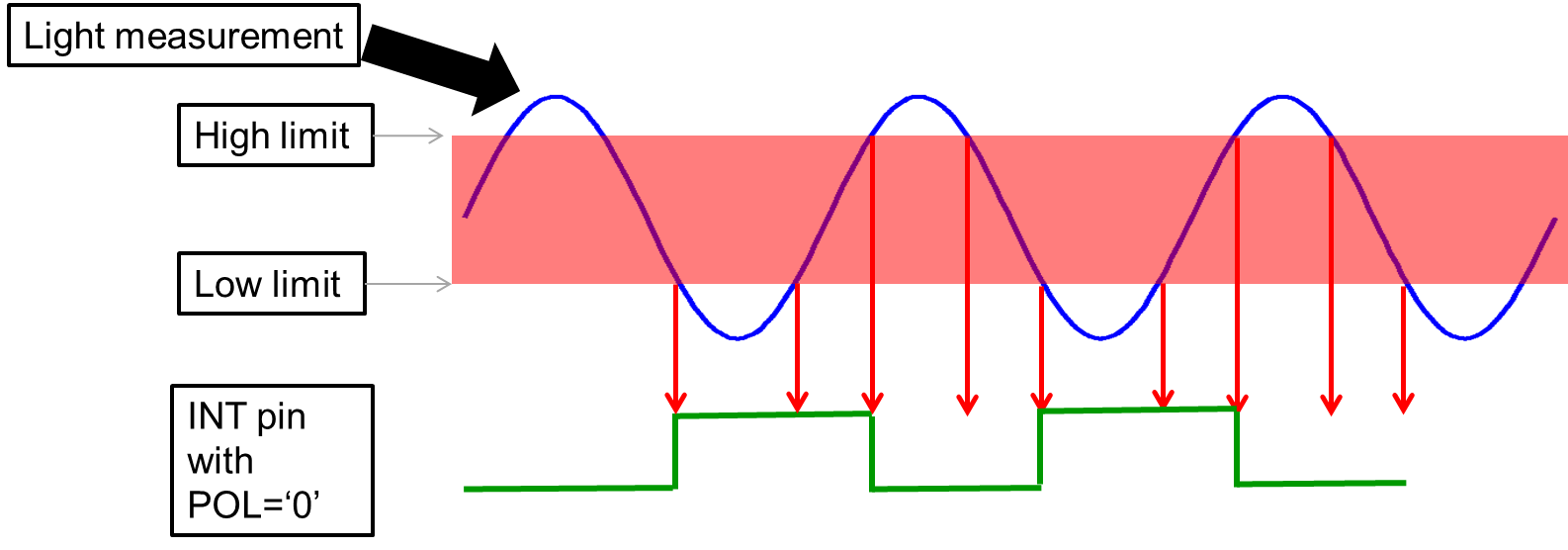

    If I understood correctly you want to have the INT pin going high when the light is below the low threshold right?
    You can configure your device to run in a Hysteresis Mode as you mentionned. Don't forget to set the low_limit=high_limit in order to have the interrupt pin changing state as soon as you're out of the low light range.
    Indeed this is how the Hysteresis mode looks like: if we have a light that goes above the threshold (with POL='0') then the INT pin goes low and remain low until we cross the low limit. So when the light is: low limit<actual light<high limit the INT pin remains in the same state than previously.
    EDIT: Changed POL='1' to POL='0'

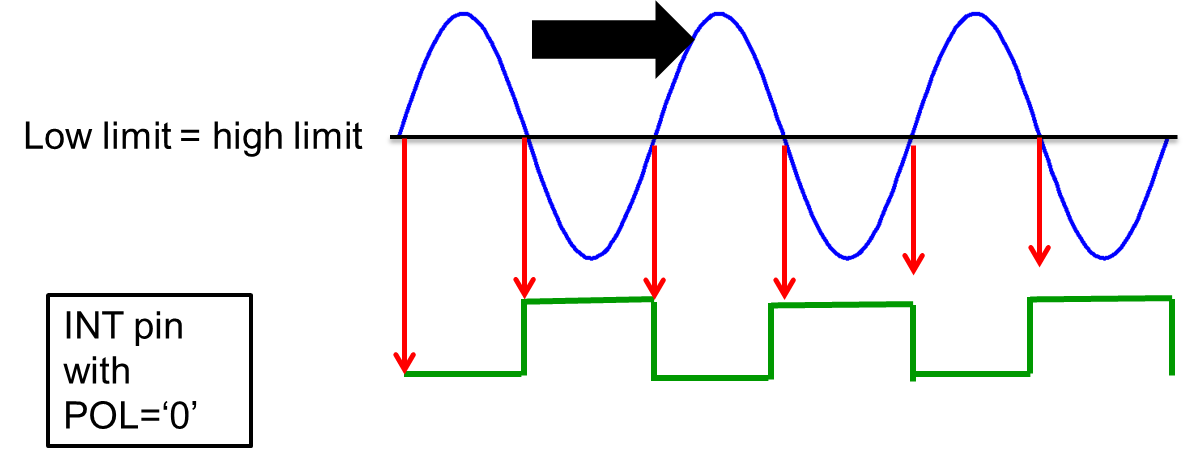

    So it's important that you set the high_limit=low_limit so in that case the INT pin will go low when light < Low_limit. In that case the int pin will behave like follows:

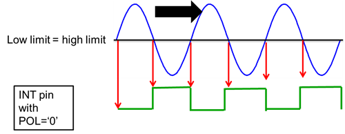

    In order to configure the device to work that way you can use these settings (0x3C00):

    I had to modify the configuration to POL=0. when POL=1 and light is above high limit , INT pin was high. Looks to me like the device was able to detect only high limit (As in Data sheet). So when POL=0 and high_limit=low_limit (0x0100) , the INT pin was high for low light.
    One suggestion is to add the figure.1 to the data sheet for better understanding
