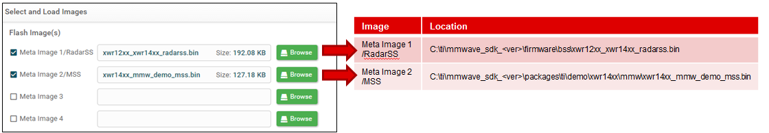

Got a Reworked AR1443EVM-010 from Keegan
Reloaded demo firmware into board from SDK using Uniflash.
Board communicates nicely on serial port.
However the app never generates data and my only clue is the following error on config:
I have tried all the default configs, with no luck not getting the Error -1. I try unchecking boxes and twiddling sliders, but always get Erorr -1.
Using Chrome Browser.
jumpers P1, P2,P3,P5 are open, P4 is closed
Chip is labelled:
XAR1443
IG
72ZEZC9
964D ABL G1
Any Ideas?
