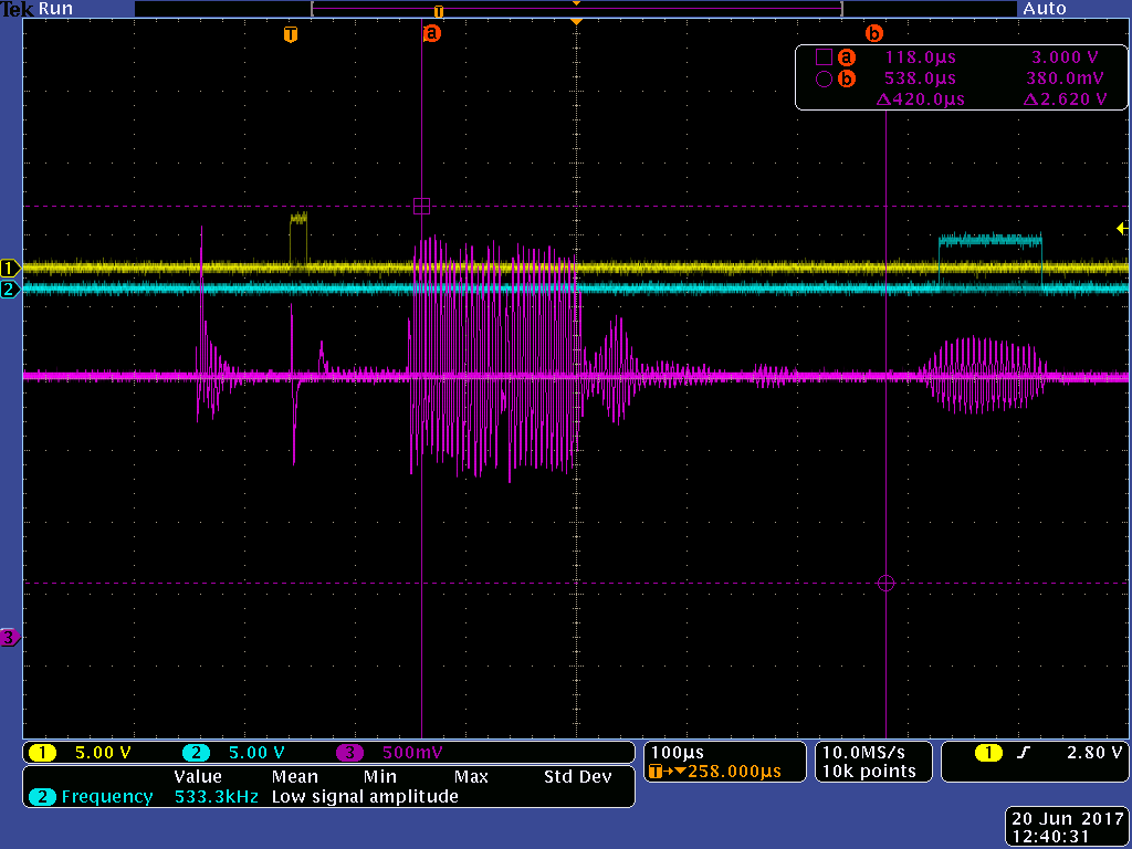

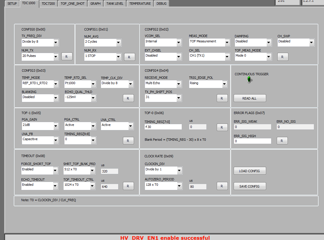

Above are my scope capture and settings for Mode 0 USING TRANSDUCER PORT #2

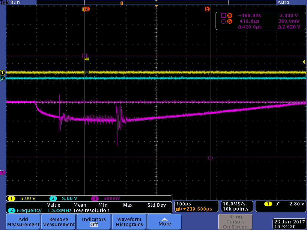

Below are my scope capture and settings for Mode 0 USING TRANSDUCER PORT #1

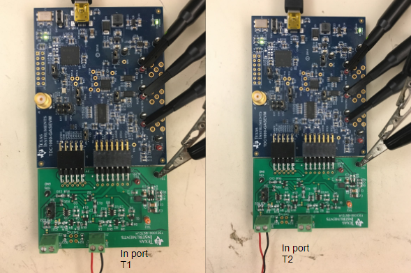

The only settings I changed were CH_SEL to T1 (and of course I turned on EN1 on the first page instead of EN2). As you can see, I am experiencing a voltage drop when I use the T1 port. I should clarify that I am using the same physical transducer each time, so that it not the problem.
Why, for the exact same circumstances, doe T1 show a voltage dip?
