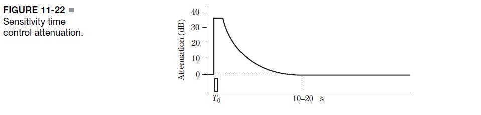

  • STC menas Sensitivity time control (STC),this is an issue in radar system, pls refer to following
    11.6.1 Sensitivity Time Control
    One method to increase the dynamic range of receivers is to decrease the sensitivity of the
    radar for near-range returns. Sensitivity time control (STC) is normally accomplished by
    inserting an attenuator between the duplexer and the receiver front end or LNA. Typically
    around 30 dB, the maximum attenuation (Figure 11-22) is switched in either at or just prior
    to transmit time. A short time following pulse transmission, the attenuation is decreased as
    the range increases. Decreasing the attenuation as a factor of R−4 would maintain constant
    amplitude for a given target RCS, whereas decreasing it as a function of R−3 would hold it
    constant for pulse-limited clutter RCS. Reducing the attenuation following an R−3.5 rule
    provides a compromise between both. The STC attenuation present at short ranges helps
    prevent receiver saturation from strong targets or clutter, and then as the range is increased
    the attenuation is reduced to enable detection of small RCS targets.
    it means low gain for near targets to avoid saturation, high gain for far target to ensure SNR

  • to elaborate this issue further, I depict scenario as below, with time of a chirp increasing, the gain of the receiver can be programmed to decrease atomatically, does TI MMIC support this function?
