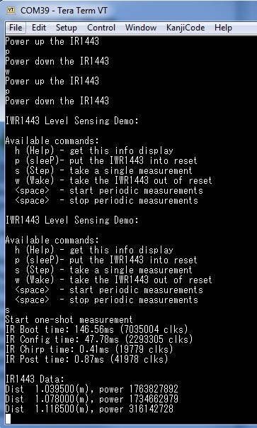

  • Can you give me screen picture what MSP432's MENU appear in the UART terminal window?
    I separate MSP432 and IWR1443 boost with the mcro USB connect to MSP432 only and launch Sera Term, the COM5 (XDS110 class application/Uer UART port) still can not open
  • There's a picture in the design guide, here's another one (below). The UART portion of the MSP432's program will work whether or not the IWR1443 is attached.

    When I plug micro USB to MSP432 board only, only the green LED on MSP432 board is light; when I disconnect mcro USB from MSP board and add 5V to IWR1443 boost board, the red LED DS2 (third one) and yellow NPST is light, when I plug micro USB to MSP board and add 5V to IWR1443 board, the green LED on MSP board is light, the two RED LED DS1 and DS2 (second and third) is light, the NPST Yellow LED also light, if I push rest button on MSP board DS2 red LED on IWR1443 is off, DS1 RED LED (third) and NPST is light. All of these with R164 is not installed, the Tera window show S, P, S, W, Space , Space menu; after installing 0 ohm on R 164, Tera window menu disappear, "can not open COM5" message are appear. I re flash both MSP board and IWR1443 board, I still get the message "can not open COM5", I remove R 164 again, the MSP menu appear again, do you know why?????
  • Hi Dave,
    I get the boards running, thanks for the help!

  • Since the reason for this thread has been answered (you are able to run the demo), I am going to close this thread. If you have performance/chirp questions, you may open another thread.
    Thanks, dave
