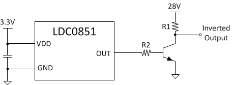

Dear Luck,
My customer wanted to connect the output from sensor to load of 200 mA.
We tried the scheme as attached.
We found as we connect NPN transistor base  to the LDC0851 output ,LDC0851 with PNP.pdfthe level for sensing is not flipping.
Please provide inputs how to drive load from LDC0851.

    You mention you want to use NPN but you've actually implemented PNP which won't work as you've drawn it, so make sure you're using the intended configuration. To connect the LDC0851 to an NPN type transistor to achieve an inverted output you can do the following:

    We Wanted to test the proximity sensor output with 200mA load wirh proximity sensing Schematic Prints.pdfhence we did testing for the attached circuit.Its working but again found to be getting  bulky additional delays power consumption.
    Please suggest , any other way to get the 200mA load driven at output.

    In your circuit, there will be an inversion between LDC0851 output and the signal labelled as O/P. Is this what you want ? If not then  you may want to eliminate the second NPN transistor.
    You may want to plot the signals, LDC0851 output, NPN and PNP outputs to find which part of the circuit contributes maximum to the delay. By adjusting the bias resistors for NPN/PNP, you can tune the base and collector currents and optimize between delay and power consumption. You should also refer the d/s of the NPN/PNP used to find out the hFE (collector current/base current) and turn on times of the transistors themselves.

    Sure! we want the 200mA current flow during sensor proximity  & normally we want no current. Also the requirement is to have 2 wires at out put one for load other for ground.
    Accordingly the circuit is working.
    Is there any other way to achieve the same in perview of reduction of components.
    Shall we try making refernce & sense coil reverse & get the rquired output to avoid the one inversion stage??

    If you are able to eliminate one additional NPN then it will definitely help reduce the solution size.
    Lesser elements, would definitely help speed up the response, but you should check if you have biased the NPN's and PNP's optimally before making a change. Looking at intermediate waveform on an oscilloscope would help provide some clues.
    In general you could simulate your circuit in a spice program . One such spice simulator is provided by TI and can be downloaded at http://www.ti.com/tool/tina-ti
    . Several vendors provide spice models for the components, which can be imported in TINA.
    One such e2e post  describes how to import a vendor provided spice model into TINA e2e.ti.com/.../452146
    I was able to put together a sample circuit in TINA to demonstrate the concept. The attached circuit is able to achieve 200mA load current within few us of LDC output switching. Choice of transistors and biasing can be modified to suit the requirements.
