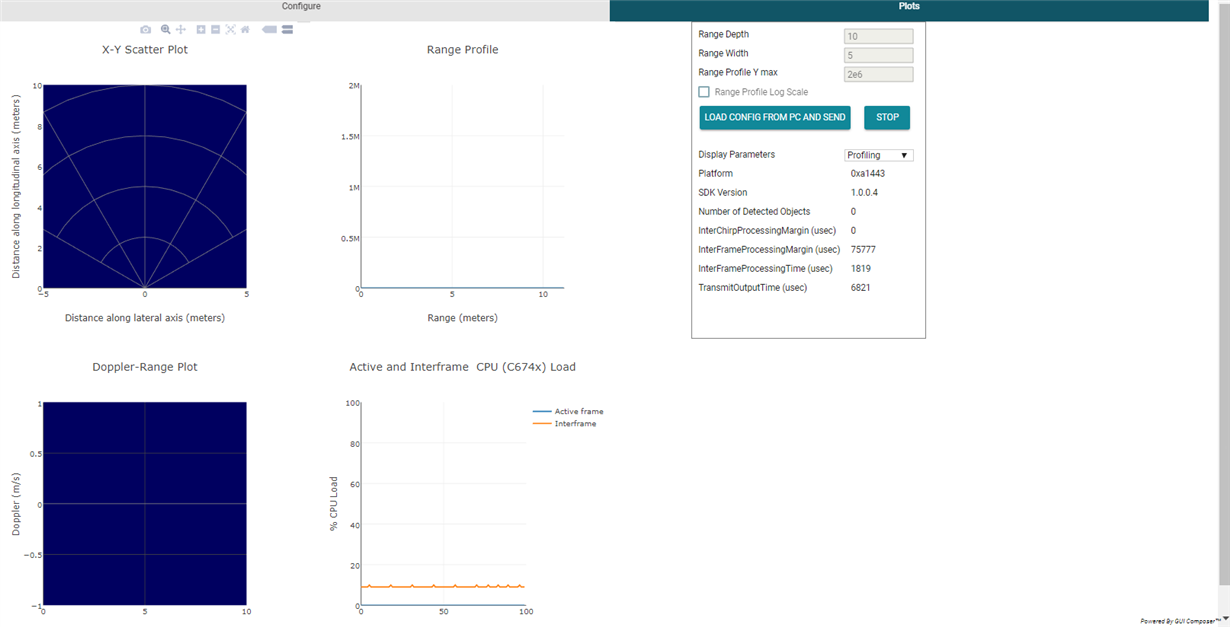

  • Hi Vaibhav,
    Yes, the CPU utilization is updating. All other plots are blank, regardless of targets or range. The board seems to be functioning. I have not changed any firmware on the board. All is as shipped
    Here is a screen shot:
  • More progress! I just used the heat maps only with a frame rate of one Hz and saw realistic data. Still no radar data.

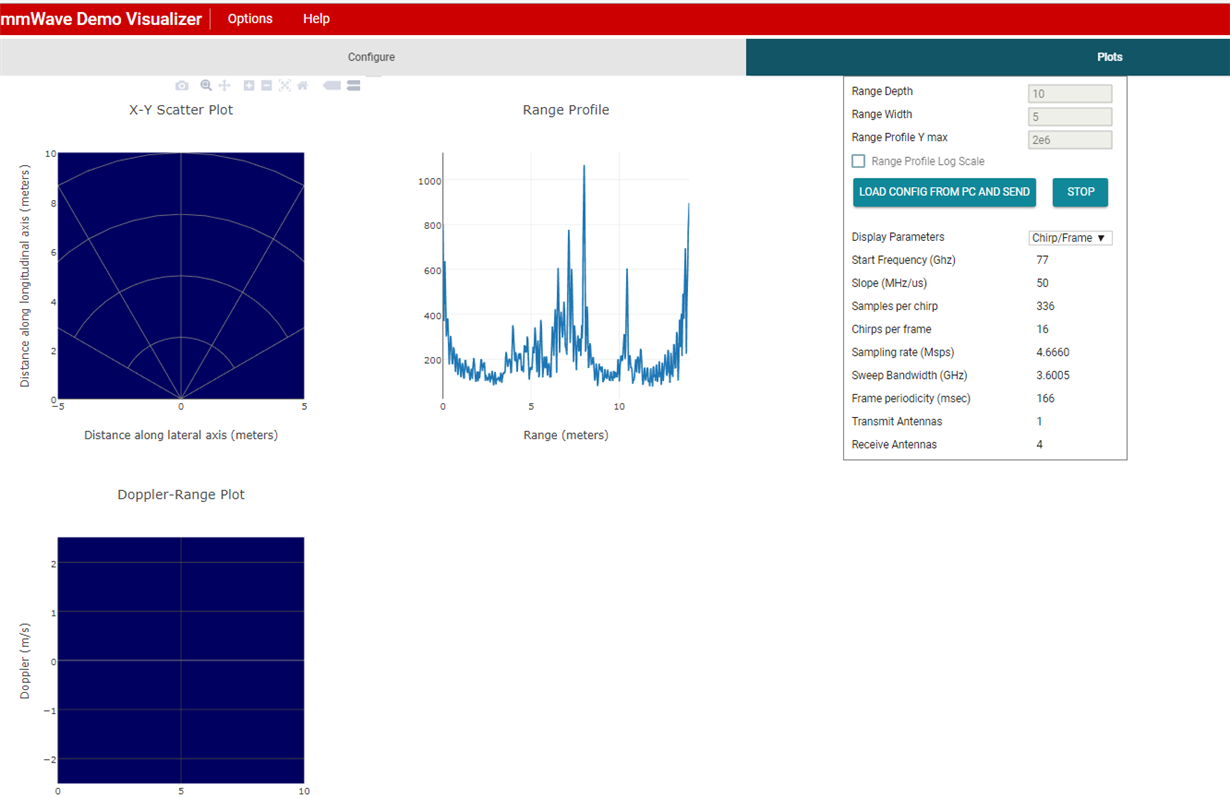

  • The USB problem has settled down. It just takes a certain pattern of resetting and the sacrifice of a small chicken.  We set the scatter and range plots, and the range profile came up with no data. Behold, when we reset the axies on the range  profile we started to see range data. The other plots are still blank.
    Here is the plot:    AT least the transmitters are running and we are getting some data.   I have to say that I have worked with TI products extensively since 1970 and this one has provided the most opportunity for unintentional discovery.  Any suggestions for the other plots?   The axis reset doesn't do it.
    David Drake
  • Hi David,
    Good to see the range plot going.
    I see no objects marked though and it could be the CFAR setting.
    Can you please try the "Load config from PC and send" button to send the cfg file provided as part of SDK.
    Typical path for the file would be as below:
    C:\ti\mmwave_sdk_01_00_00_05\packages\ti\demo\xwr14xx\mmw\profiles\profile_2d.cfg
    Thank you,
    Vaibhav

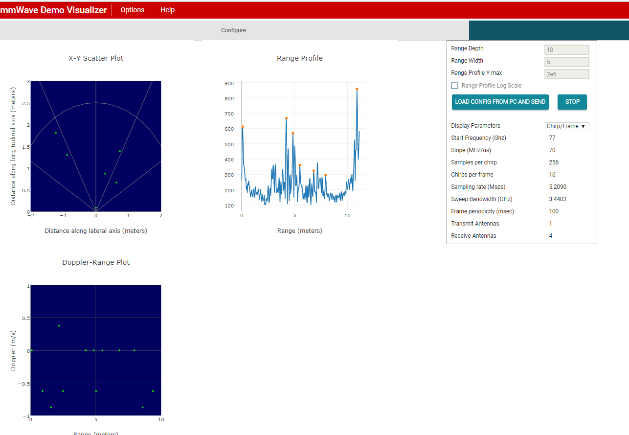

  • Dear Vaibhav,
    Success! The CFAR settings are actually marked as "Range and Doppler Detection Threshold" in the Visualizer UI, by setting these to 5 rather than 15, all of a sudden, like ghosts from ancient radar antiquity, dots started to appear. Their placement was logical. Very good advice.
    So we will proceed...
    David Drake
  • Hello David,
    Glad to know that CFAR setting were enough to get this to work.  CFAR thresholds set the level above which a certain frequency peak gets denoted as an object these have to be adapted to the scene. The Out of Box values work for a wide variety of scenes seems like it needed some tweaking for your scenario.
    Please feel free to check out the "CFAR Cfg" field in the mmWave SDK user's guide.
    IWR1443/AWR1443 has a CFAR hardware and select few settings of this hardware are controlled by the "CFAR Cfg" field of profile sent to visualizer or by altering the "Range and Doppler Detection Threshold" in the Visualizer interface.
    Details of IWR1443/AWR1443 CFAR hardware are covered in Radar Hardware Accelerator User's Guide - Part 2 .
    Thank you,
    Vaibhav
  •  An image where CFAR values set to 5
