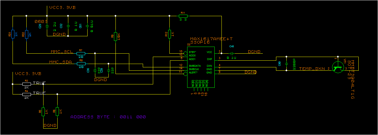

Please help review below TMP400 schematic. Thanks!
Also PNP or NPN both work?

    Yes, NPN or PNP transistors can be used. Your sensor configuration and schematics look good. Here are two minor notes:
    1. It may be possible to use higher value I2C pull-up to reduce power consumption.
    2. Layout recommendations: move C49 as close as possible to D2. Keep the traces between D2 and VT1 short. If noisy traces run close to the D2-VT1 traces, shield the D2-VT1 traces by moving D2-VT1 to an inner layer and adding GND traces on either side of the trace pair, as well as on the layers above and below.
