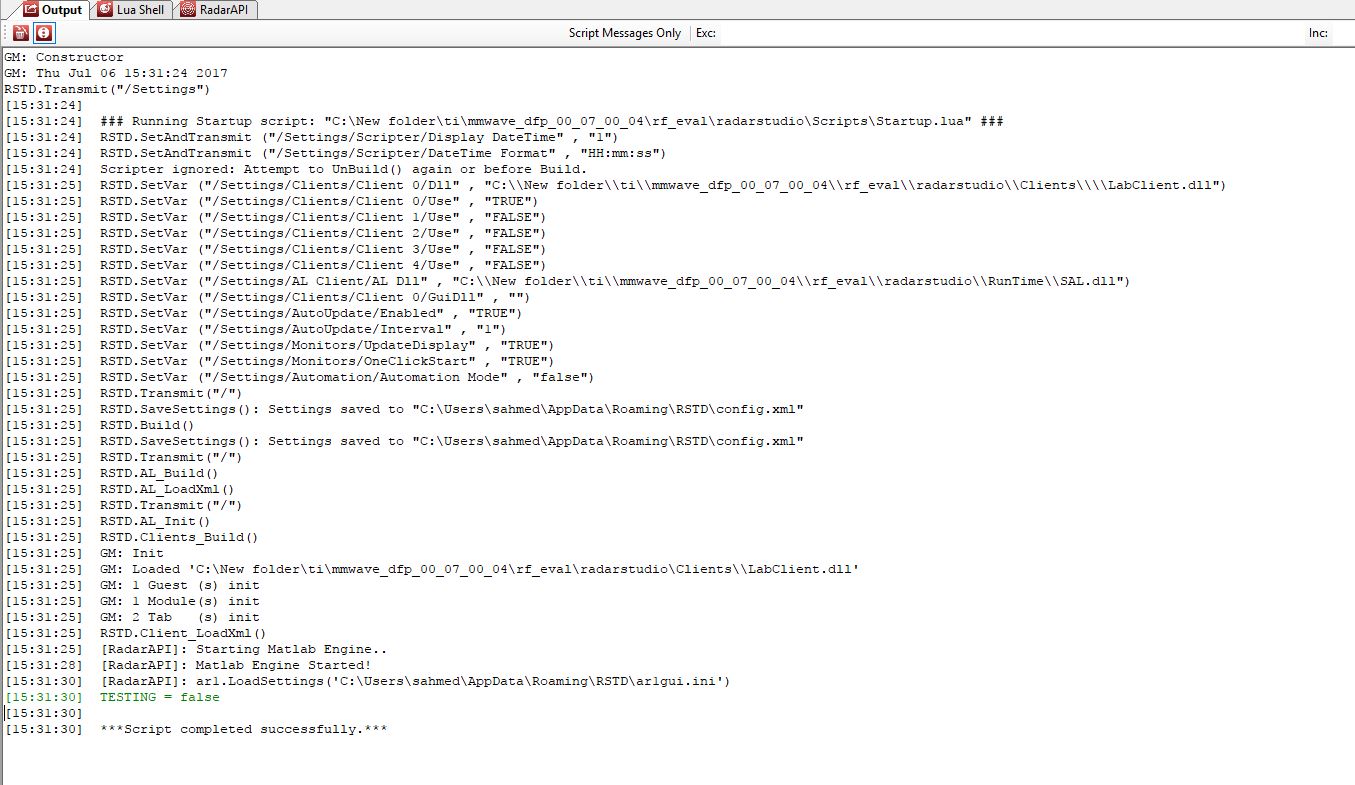

I have installed the mmWave DFP and opened the Radar studio, as soon as I open the application it shows error as "object reference not sent to an instance of an object". I have Reinstalled it, but still it is showing the same error.
Vinayak
Hi Vinayak,
This is a stupid solution but what worked for me was I moved the ti folder into a new folder so it went from:
C:\ti\mmwave_dfp_00_07_00_04
to
C:\New folder\ti\mmwave_dfp_00_07_00_04

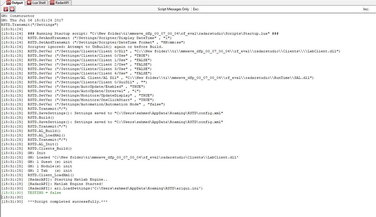

This does result in an another error:
but I don't know if this causes any issues as I am still able to run RadarStudio:
