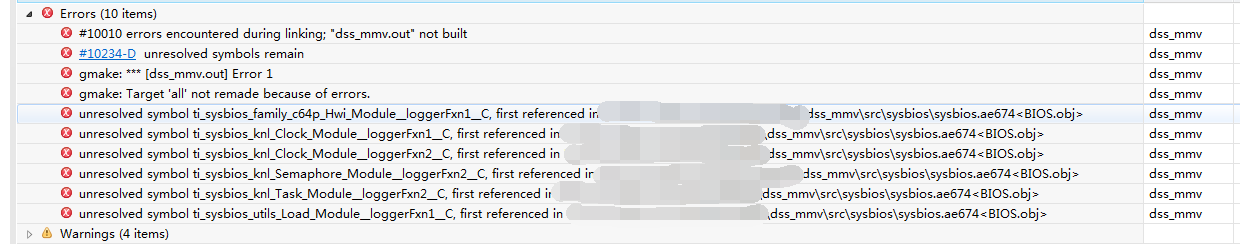

Hello Anist,
As per your log snapshot looks like while compilation sysbios.ae674 is not getting generated inside your project path.
Can you check your DSS project configuration (dss_mmw.cfg) for BIOS libType if it's set to 'BIOS.LibType_Custom'.
Apart from this please match Sysbios version with mmWave-SDK release note and check sysBios path is valid in your CCS project.

Hello Anist,
Do you have the correct version of all tool dependencies (BIOS, XDS, CCS etc.) what mmWave-SDK release note recommends?
You can use CCS resource explorer to get working CCS project for mmWave-SDK demos.
