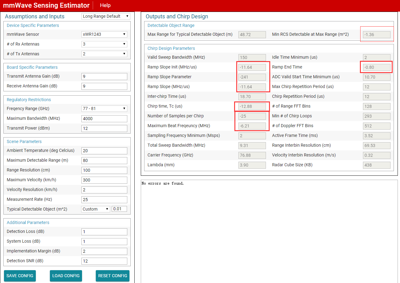

    As a starting point you can look at the sensing estimator tool (dev.ti.com/mmwaveSensingEstimator) to verify if your required sensing parameters would be met.
    By default a max velocity of 300kmph would not be possible , but there are some higher level algorithms that can be used to measure velocity higher than the max unambiguous velocity provided by a radar sensor. You can look for these algorithums online.
    Vivek
  • Hi Vivek
    This happens when I use the sensing estimator tool to verify if my required sensing parameters would be met. I just give this for an example.
    What's the reason to have negative value?
    Thanks for your time effort.
  • Hello Will,
    Looks like there is a bug in the tool that its not able to highlight the invalid configuration in this case and is ending up computing a negative value.
    Like I mentioned earlier 300km/hr with a 80 m kind of range would not be directly feasible without higher level algorithms. You would have to set a lower max velocity and then use higher level algorithms to compute a velocity that is higher than the max unambiguous velocity. What the tool lists is only the max unambiguous velocity.
