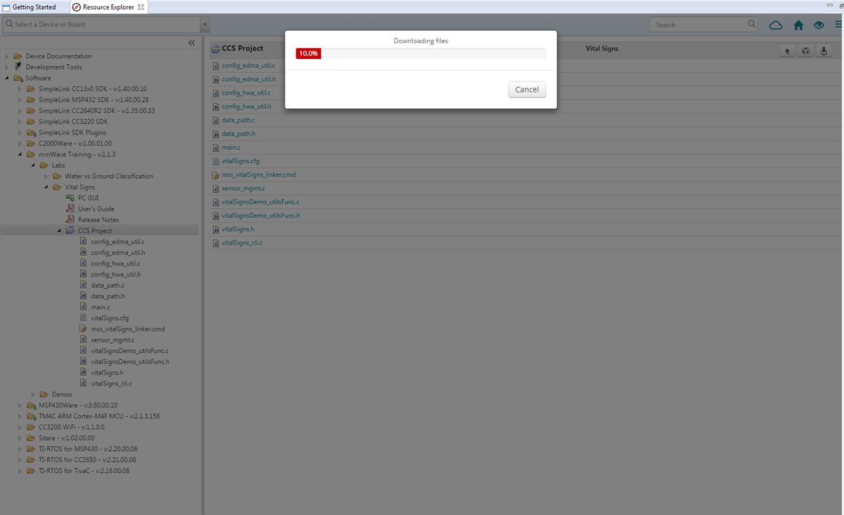

Hi Champs,
I couldn't import vital demo. I found similar thread . but, I couldn't import it CCS ver7.1 also.
Phenomenon is here
It doesn't proceed download counter. Even I re-boot PC. It was same phenomenon.
but, when I tried to down load these files from CCS cloud (Resource exploler). It could download. but, CCS cloud didn't exixt Import to IDE bottom.
So, I couldn't convert file to CCS IDE style.
Do you know any reason ?
Also, if you have any tool to convert this file to IDE style, please let us know.

  • Hi Champs,  I have some update about this.
    I could download this demo file when we link web base "Resource exploler". Then I tried this demo to CCS ver 7.2. but, ccs7.2 couldn't import these file. So, when I changed ccs version to 7.1. I could import code. but, it has many compile error.
    Could you check this error log and tell me some workaround ?
    Error log is attached.

  • Hi Kz777,
    The error log you attached shows that the BIOS version on your desk is 6_46_04_53.
    'Invoking: XDCtools'
    "C:/ti/xdctools_3_50_00_10_core/xs" --xdcpath="C:/ti/bios_6_46_04_53/packages;C:/ti/ccsv7.1/ccs_base;" xdc.tools.configuro -o configPkg -t ti.targets.arm.elf.R4F -p ti.platforms.cortexR:IWR14XX:false:200 -r release -c "C:/ti/ccsv7.1/tools/compiler/ti-cgt-arm_16.9.1.LTS" "../vitalSigns.cfg"
    The Vital Signs Lab (and all other Labs and Demos included in the mmWave Training Series) require SYSBIOS 6.50.1.12. Can you please install the required tools as mentioned in the pre-requisites section of the corresponding lab setup guide, delete the current project and re-import to IDE from the resource explorer?
    -Nitin
  • Hi Nitin,
    Thanks. it works.
