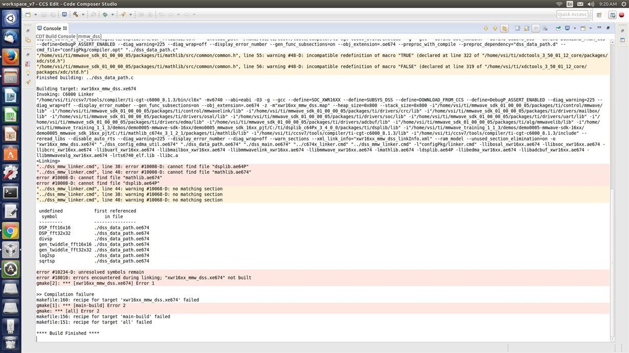

Hi all,
I am trying to run the mmw demo but when I try to compile the mmw_dss project, I get the error that the dsplib.ae64P and matlib.ae674 files are missing. However I have already installed appropriate versions of mathlib and dsplib.
Another error I am getting is as follows :
undefined     first referenced
symbol           n file
DSP_        fft16x16 ./dss_data_path.oe674
DSP_        fft32x32 ./dss_data_path.oe674
divsp         ./dss_data_path.oe674
gen_twiddle_fft16x16 ./dss_data_path.oe674
gen_twiddle_fft32x32 ./dss_data_path.oe674
log2sp ./dss_data_path.oe674
sqrtsp ./dss_data_path.oe674
I checked and I already have these header files in the directory.
What could possibly be going wrong?

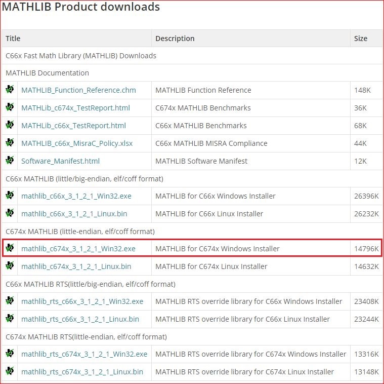

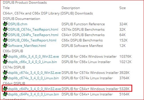

  • Amol,
    Can you please ensure that you have the exact versions of DSPLIB and MATHLIB, as mentioned in the mmWave SDK 1.0.0.5 release notes, installed on your workbench? The corresponding download pages for both library have multiple installers (with different target architectures). I have highlighted the installers you need to select in the images below:
    1. C64x+ DSPLIB version 3.4.0.0
    2. C674x MATHLIB version 3.1.2.1
    -Nitin
  • Hi Nitin,
    I am using the exact same versions of both the libraries only difference being that they are in Linu.bin format.
    You can see that the errors are as follows :
    The other files like DSP_fft16x16 also exist and are inside the ti folder. But still it shows to be undefined symbol. I feel there is some issue with linking of these 2 libraries with the code composer studio compiler.

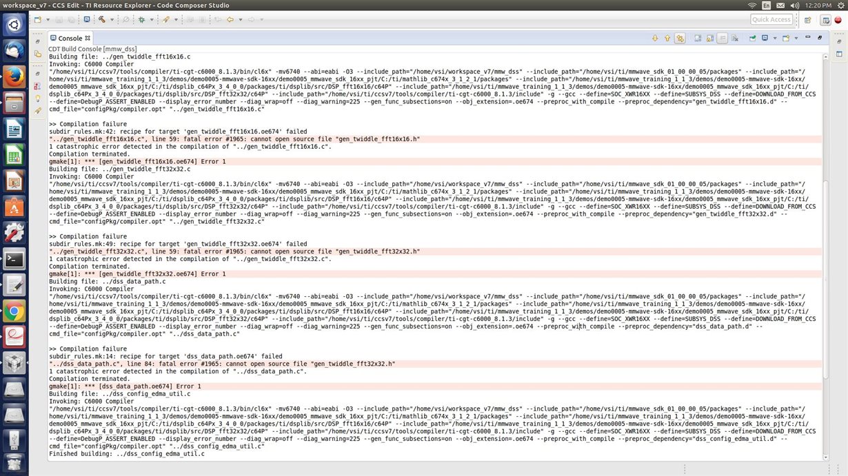

    Hi Nitin,
    I followed the steps which you recommended but still no success. I have the following errors now. Also while compiling I can see some gmake commands which are related to windows. Is it advisable to build the project then using the make file ?
  • Amol,
    From your previous post, it appeared that you had the compilation going successfully and the build failed at linking, attributing to dsplib and mathlib. It appears that you haven't modified the projectspec correctly since I can see the following in your compilation output:
    You need to replace the path with your Linux path.
