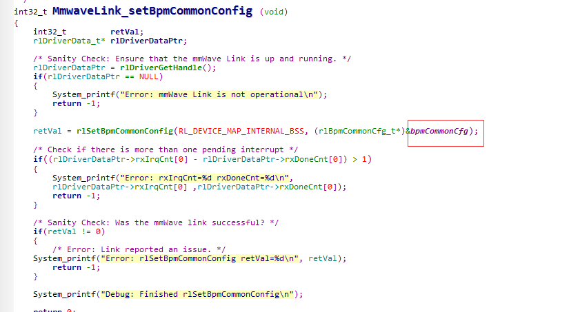

Hello ,
When I'm going to run the "MmwaveLink_setAdvFrameConfig" , I found the params of  " advFrameCfg" was like that :
 Why  you set all of them to "0" ? It's a bit hard to understand  , can you provide  a complete parameter ?

  • Hello Anist,
    We will be adding more details on the advanced frame config in the subsequent releases. For now you can find the parameter details in the "AWR1xx_Radar_Interface_Control" document which is part of the DFP package (www.ti.com/.../mmwave-dfp). The API parameters are explained in that document.

  • Hello Anist,
    Here is the code snippet for your reference-
    /* adv frame configuration */
    uint8_t numOfSubFrame = 0U;
    rlAdvFrameCfg_t advFrameCfg = {0};
    /* first sub-frame configuration */
    advFrameCfg.frameSeq.forceProfile = 0;// 1: force Profile, 0: Don't force profile
    advFrameCfg.frameSeq.numFrames = 0;//infinite
    advFrameCfg.frameSeq.triggerSelect = 1;//SW Trigger
    advFrameCfg.frameSeq.frameTrigDelay= 0;
    advFrameCfg.frameSeq.subFrameCfg[0].forceProfileIdx = 0;
    advFrameCfg.frameSeq.subFrameCfg[0].numLoops = 64;
    advFrameCfg.frameSeq.subFrameCfg[0].numOfBurst = 1;
    advFrameCfg.frameSeq.subFrameCfg[0].numOfBurstLoops = 1;
    advFrameCfg.frameSeq.subFrameCfg[0].chirpStartIdxOffset= 0;
    advFrameCfg.frameSeq.subFrameCfg[0].numOfChirps = 1;
    advFrameCfg.frameSeq.subFrameCfg[0].chirpStartIdx = 0;
    advFrameCfg.frameSeq.subFrameCfg[0].subFramePeriodicity= 20200000; // 101 msec
    advFrameCfg.frameSeq.subFrameCfg[0].burstPeriodicity = 20000000; // 100 msec
    advFrameCfg.frameData.subframeDataCfg[0].numAdcSamples = 224*2;
    advFrameCfg.frameData.subframeDataCfg[0].totalChirps = 64;
    advFrameCfg.frameData.subframeDataCfg[0].numChirpsInDataPacket = 1;
    numOfSubFrame++;
    advFrameCfg.frameSeq.subFrameCfg[1].forceProfileIdx = 0;
    advFrameCfg.frameSeq.subFrameCfg[1].numLoops = 32;
    advFrameCfg.frameSeq.subFrameCfg[1].numOfBurst = 1;
    advFrameCfg.frameSeq.subFrameCfg[1].numOfBurstLoops = 1;
    advFrameCfg.frameSeq.subFrameCfg[1].chirpStartIdxOffset= 0;
    advFrameCfg.frameSeq.subFrameCfg[1].numOfChirps = 1;
    advFrameCfg.frameSeq.subFrameCfg[1].chirpStartIdx = 1;
    advFrameCfg.frameSeq.subFrameCfg[1].subFramePeriodicity= 20200000; //101 msec
    advFrameCfg.frameSeq.subFrameCfg[1].burstPeriodicity = 20000000; //100 msec
    advFrameCfg.frameData.subframeDataCfg[1].numAdcSamples = 224*2;
    advFrameCfg.frameData.subframeDataCfg[1].totalChirps = 32;
    advFrameCfg.frameData.subframeDataCfg[1].numChirpsInDataPacket = 1;
    numOfSubFrame++;
    advFrameCfg.frameSeq.numOfSubFrames = numOfSubFrame;
    advFrameCfg.frameData.numSubFrames = numOfSubFrame;
    retVal = rlSetAdvFrameConfig(RL_DEVICE_MAP_INTERNAL_BSS, &advFrameCfg);
    you need to call this API after profileConfig and chirpConfig APIs are called.
