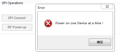

    Customer has connected SPI_CS,   SPI_MISO, SPI_MOSI, SPI_CLK,  SPI_HOST_INTR, GND from own board to dev pack. After downloading the firmware and click SPI connect button, customer got below error. Would you pls kindly advise what may cause below error?
    We also found if no board is connected to PC and we open radar studio, then click SPI connect button we will see same error.
  • Hello Chris,
    If the FTDI device is detected properly , on the top right corner of the radar studio you should see the "No. of Devices Detected: 1" and FTDI status connected. Do you see that?
    If that is happening , you should click on SOP set and RS232 connect , download the firmware , before you do SPI connect.
    Vivek
