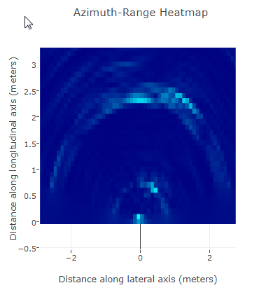

I am working on the IWR1443 sensor board and able to run sample demos.
I am interested in DEPTH MAP generation using the sensor board. Is there any application/procedure for this?
Thanks & Regards,
Siddartha
  • Hello Siddartha,
    You would want to try the Azimuth-Range Heatmap via the mmWave Visualizer GUI. This option can be enabled under the Config Tab -> Plot Selection tick.
    Once ticked, hit "Send Config to mmwave Device".  It will ask you to keep the Frame rate below 1FPS for uart data rate reason.
    Plots area will show a new plot as below. Please zoom in as needed to see the heat map of reflections from objects near the sensor:
    Objects with stronger reflection appear brighter in the plot.
