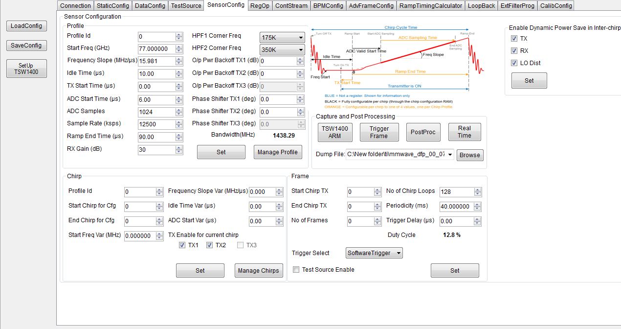

For Above profile configuration I'm unable to capture the data, but when I set ADC start time to 0.03, I'm able to capture the data, but data is not as good as when I capture with 256 ADC samples.
Please explain how it works.

    I changed frequency slope to 16MHz, sampling frequency = 12500, ADC start time=0.03uS, Ramp time = 90uS, Idle time = 10uS, ADC samples = 1024 rest of the things are same as default values, and I'm looking at Time Domain Plot, its not giving proper sine wave. And is ADC samples restricted 256 max?

    I tried for 1024 samples, for below configuration. I'm getting a large spike data in time domain plot.
    Here is configuration .
    frequency slope to 64MHz, sampling frequency = 12500, ADC start time=0.03uS, Ramp time = 45uS, Idle time = 10uS, ADC samples = 1024.

    Are you seeing the spike in the beginning of the chirp? You have the ADC start time kept to 0, so the synth and PA would not have settled , can you increase the ADC start time and check?

    I also noticed that you have the ramp end time as 45usec. If you have 1024 samples with 12500 Ksps , this would mean the ramp end time has to be > 82usec. This configuration should have given an error, am I missing something here?

    Yes, I'm seeing spike in the beginning of the chirp. I have also tried for the ADC start time to 6us.
  • Hi Vivek,
    I din't get any error for the ramp end time, and i have also tried for this configuration,
    I have changed the profile configuration to
    frequency slope to 32MHz, sampling frequency = 12500, ADC start time=6uS, Ramp time = 90uS, Idle time = 10uS, ADC samples = 1024.
    I got same spike result for this configuration too.

    Sorry for the delay on this thread. Do you have a snapshot of the spike you are seeing?
